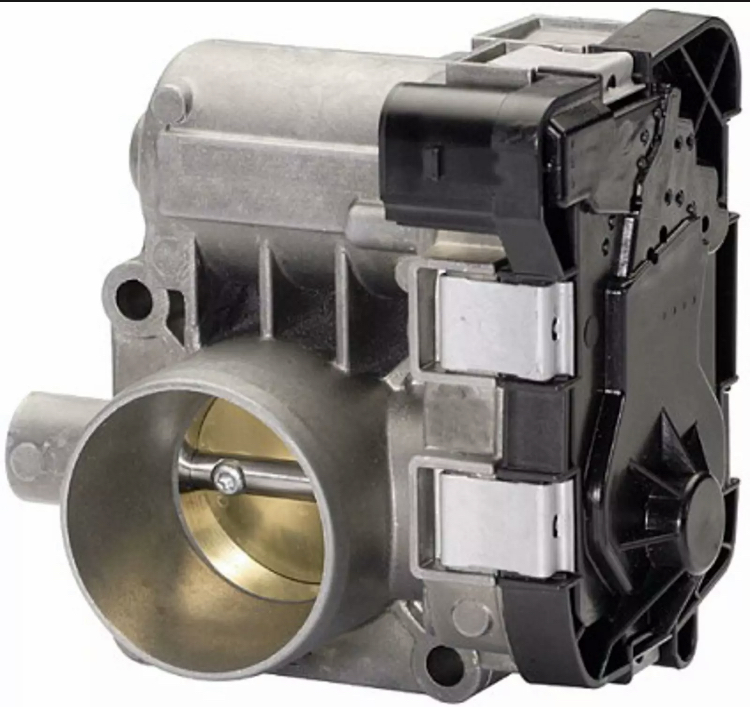

Will it start with the throttle position sensor disconnected ? (Throttle body not accelerator pedal sensor ) not sure if this would work mind.
But I did mention the tension to be measured on both injector's lines, (+) and ground. If there is no voltage, then you can each one of them separately, connecting the other multimeter's connector to a good source like battery terminals. But if there is voltage on the lines, injector's (+) and (-) it means that is no problem there.Injectors are normally switched to ground by the ECU, so having voltage on them doesn't mean they are working.
I cant connect the sensor. Its all in one electricity.Will it start with the throttle position sensor disconnected ? (Throttle body not accelerator pedal sensor ) not sure if this would work mind.
Throttle is closed at start. Ecu gets wrong values in.I'd say that you definitely need to replace that sensor. That bad reading that it gives... I don't see how you could make it work without replacing it.
All you have to look for now, is the minimum replacing part that you can buy, cause I'm sure there are many experts that would suggest that in this case all throttle body should be replaced.
And technically, the reason the engine doesn't start I'd say it's the fact that it gets flooded. Because the amount of injected fuel is strong relation with the TPS reading. And 100% open means that a lot of fuel goes in.
So to fix it, TPS sensor needs to be replaced.
To manage to start the engine, see if anything modifies in good, TPS sensor to show accurate reading, I think you could press the acceleration pedal, that way you give engine air too, not just a lot of fuel. Or does the throttle butterfly moves according to the false reading and it is already full open when you crank the engine?
That's my point disconnect the plug and try starting, whilst it won't rev it may well start and idle given often the sensors are at their maximum resistance when closed ( so will be infinite unplugged ) and gradually go towards nil when fully open, at best it might start?I cant connect the sensor. Its all in one electricity.
Okay. I'm going to try it tomorrow.That's my point disconnect the plug and try starting, whilst it won't rev it may well start and idle given often the sensors are at their maximum resistance when closed ( so will be infinite unplugged ) and gradually go towards nil when fully open, at best it might start?

There's a potentiometer hidden there I think.At the TB type you have, seems that there is no IACV so I presume all the air engine gets goes through throttle butterfly. Maybe that's why it doesn't start, because there is no air. Try holding the butterfly a little bit open, with your hands, while someone else helps you and cranks the engine. See if it starts like that.
Throttle pedal indicates "idle position" to ECU so maybe that's why lack of fuel ECU will be confused if wide open and idle signal?But if the ECU thinks the throttle is wide open, why are the plugs dry?

If there is a potentiometer there (and it should be), it probably stays closed due to 100% throttle opening that ECU misreads, so no air gets to the engine and this is the reason it does not start. You should definitely fix the TPS problem.

Im slightly confused you say the live data says throttle wide open when the butterfly is closed, but you also say it moves correctly when you press the pedal when trying to start?
So is the butterfly potentiometer broken saying wide open but the actuator working correctly as per the accelerator pedal position?
