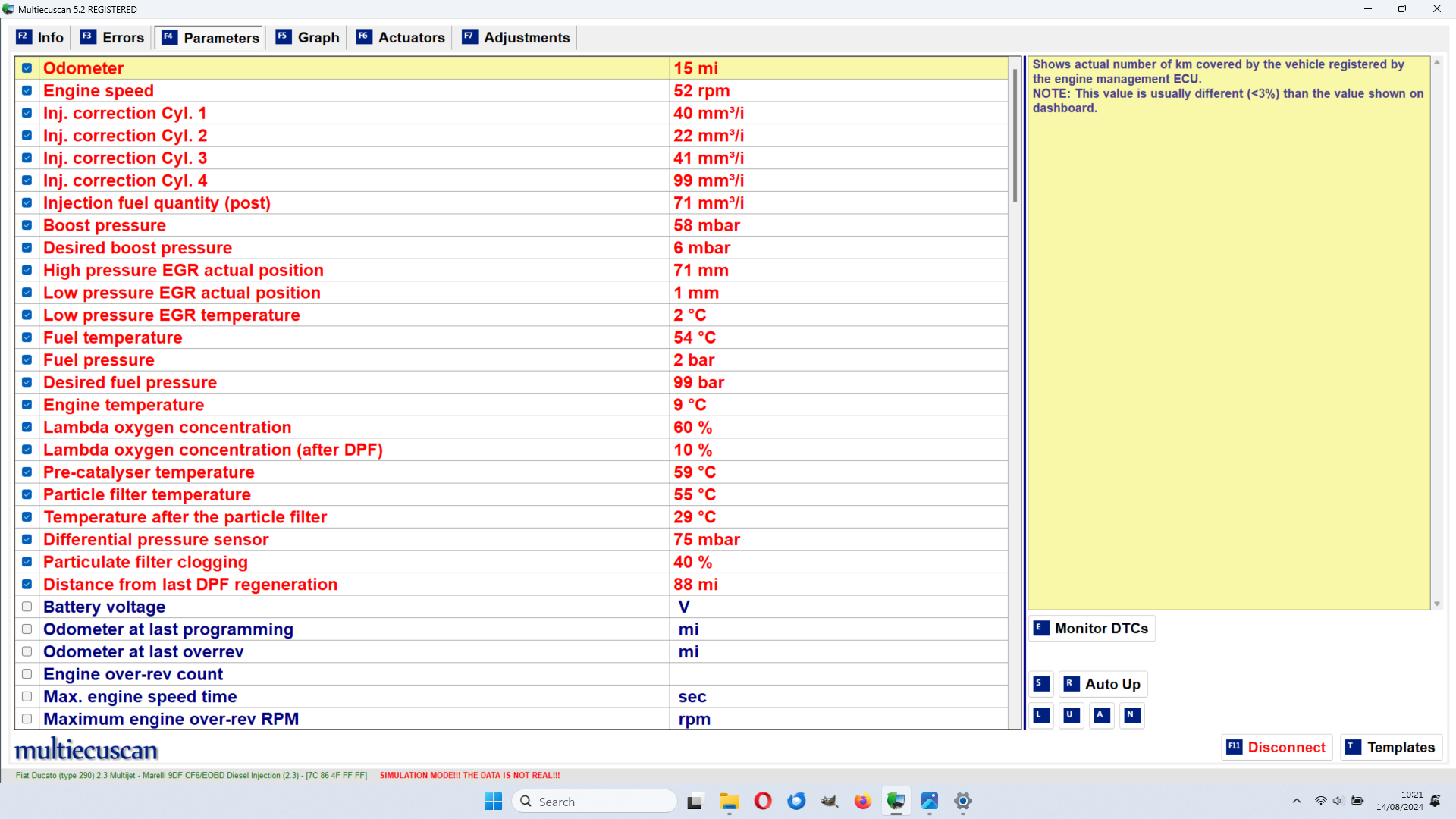

The Twin Egr model is famous for a particular failure mechanism.
Now i'm not suggesting yours is suffering from this, but reading this will give you an idea of how complex the EGR/DPF system is.
IT also gives a flavour of how USing live data from Multiecuscan can help.
In order to do this you would need a copy of multiecuscan on a windows laptop and collect data (using a specific template) from a 30 min run.
Now one last question at 2016 are you sure its a twin egr. Where is the Dpf, low down on offside or high up behind the engine?

I'm asuming the HPegr is blocked/ stuck and motor is struggling. the Sensor B any one know which sensor this is. If i could get live data we could be sure which egr hp or lp. in my database of codes there is no reference to LPEGR.
