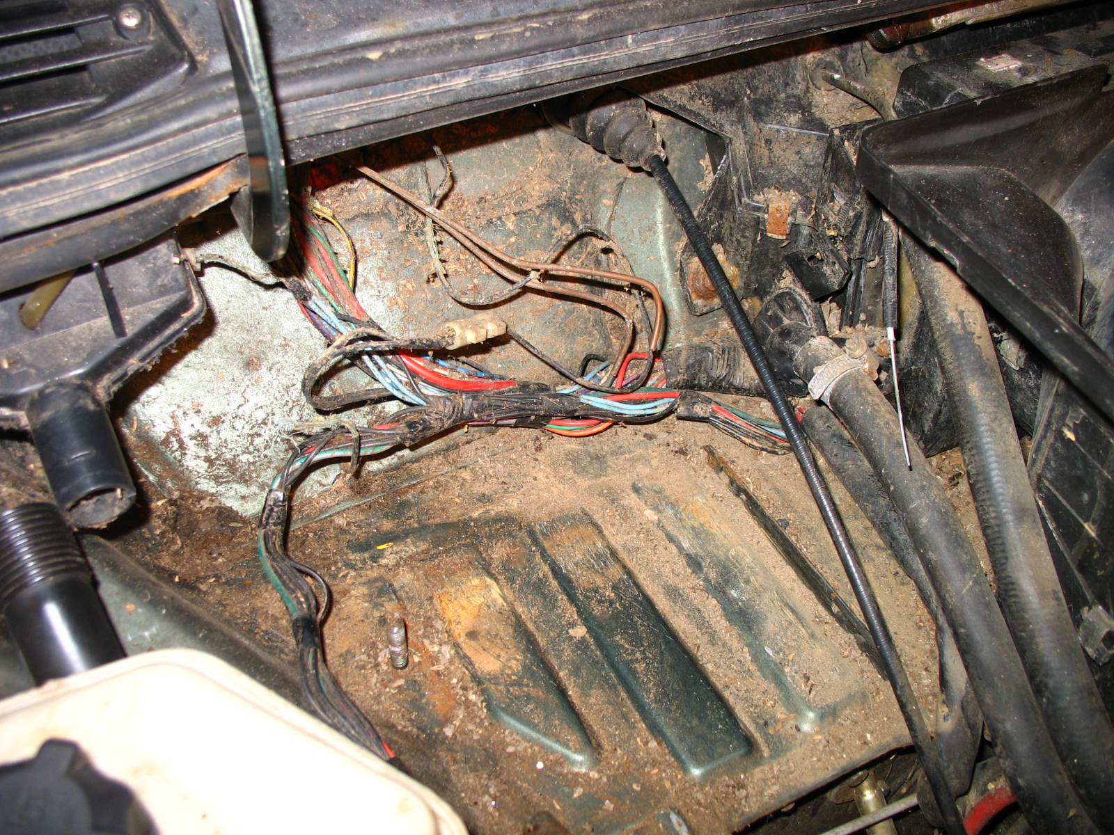

Re he heater matrix, undo the battery, relaese the sound barier thing from driver side and you should see a valve on the far end of heater matrix.
Make sure the valve arm opperate free and in full range ( 7 to 11 on the clock). Possible air lock as well, undo the return hose with running engine, no heater bleeding points on 4x4 coolant hoses.
I messed with the levers on my journey home and it seemed to start working again - must have just been something stuck a little after the car has been standing. Might be worth stripping out the airbox and cleaning it all up when I get a dry day, I've read old threads about how much gunk can get stuck in there.
re. your original question - yes there is a big plastic flap in the airbox that controls the airflow. If you take the rubber seal off the rim and lift out the grill you'll see it clearly and if you can get someone to operate the airflow lever inside the car , next to the temperature control, you should see it moving. My guess is either cable from the lever, or flap was jammed in the closed position.
