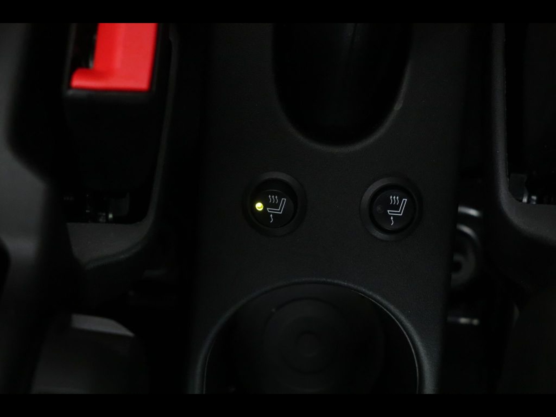

I found this picture of a car with heated seats so I could either retro fit into the existing centre console or try to get the replacement console. IMG_4750.JPG
These look like aftermarket switches anyway. I am not sure if there is a factory option at all.

Switches are either on the bottom end of the gearbox cover if there is enough space, depending on switch size and facelift, or as in your pic in the center console. In theory, you might even be able to fit them in the plastic side covers of the seats (available depth needs to be checked, though).
