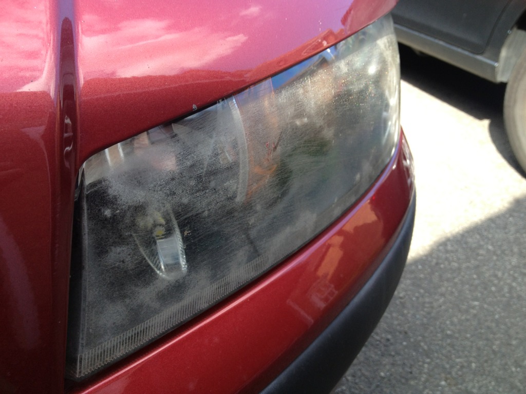

My headlights are looking very shoddy got a lot of surface scratches and its really ruining the look of the car :( and recommendations of how to get rid ? Cleaning kits or whether the plastic needs replacing ? Cheers ImageUploadedByFIAT Forum1375454142.127244.jpg

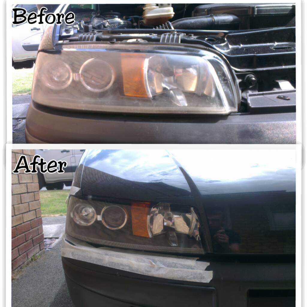

Pic -

Does anyone know weather you can just buy the outer plastic instead of the whole headlight ? I've been thinking and I reckon the scratches on the headlight are too deep to be taken out by a kit ... Looks like a previous owner has had a go at it with sandpaper :( a real mess

Get lens from a scrap car - but you'll need light cluster out todo it
So you might as well just take 2x lights clusters out
2 - try the kit
if your unsure it'll survive a clean up - and it does - your quids in
if it doesn't - well tough luck - you tried and you have to get a new light cluster set

You might aswell for a restoration kit, like others said the 3M kit sounds good. Although I can personally recommend the turtle wax kit.
My headlights had previously been scratched with sand paper badly and the kit did a pretty good job of sorting that out.
Won't go wrong following ziggy's advice, well at worst lose a few quid :rolleyes:
Hi guys I restores my headlights back the other day they were really bad and didn't want to fork out on new ones so I thought I would try something I used p1200 wet and dry paper with water and rub over the lenses not to hard untill the bad stuff comes off then wash off and dry use t cut and give it a good rub then buffer up and it actually works perfect like new again instead of paying £20 for kit
