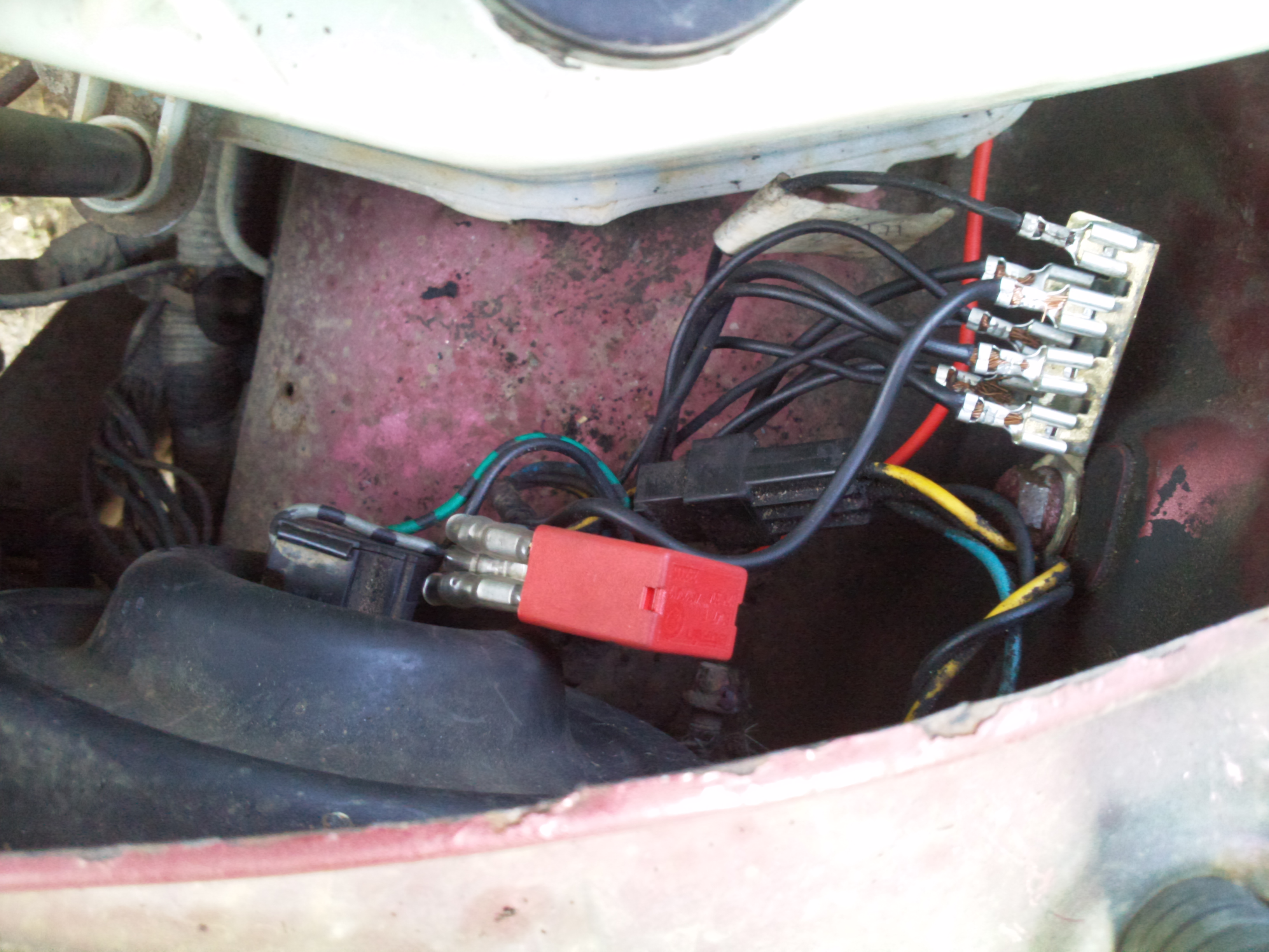

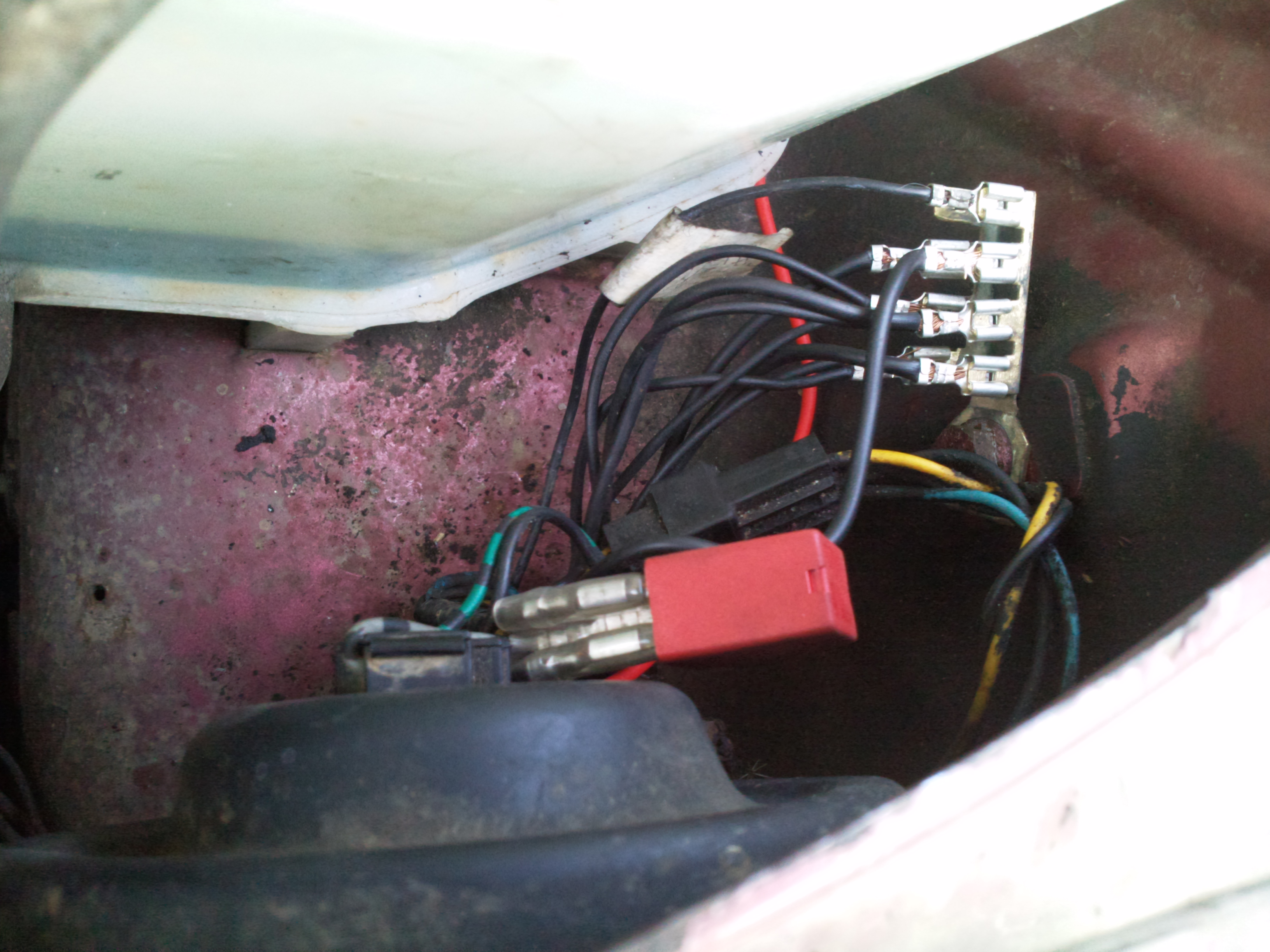

Here was a quick dipped beam upon relay upgrade I done on my old Sisley
