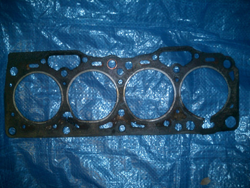

Ok well heres wat happens to a Head Gasket when you are running 1 Bar of Boost, and you have 4 girls sitting in the car which is lowered -35mm and u hit a speed bump and damage the thermostat, which is then blown off completely, Leaking all coolant, overheating the engine and then boiling the engine oil all in a days work :D
But least i got it all fixed now!! So i'm still smiling :D
