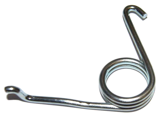

The spring on the caliper is supposed the return the lever. If that's not happening, then the handbrake mechanism inside the caliper could be seized.

I've sprayed releasing fluid around the lever pivot and it seems to be moving when I press it forward The spring is located correctly and is pulling the lever back when the hand brake is off. I suppose all I can do is wait to see if the problem happens again and then change the caliper.
