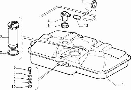

Well ive disconnected all the pipes (broken a bit on the top of the tank, hoping i can swap this with the one off the porous tank) and taken out all 3 bolts holding the thing in, and its only dropped at the back, for some reason the front of it is still hanging, can anyone think why this would be? need help before it gets dark if possible :eek:
EDIT: Got it off, missed 2 nuts :eek: only realised when i saw the pics out of camera... Anyway new question, see bit further down page :)
not really, will show u a pic sometime lol :p
*points to drawing* the thing labeled as #4 is broken :( the bit that sticks out slightly has snapped and the bit of it that sticks out is in the hose that pulled off of it (well and pulled it off too lol)
anyone know if this is removeable? as if it is i can use the one off the red 'un
