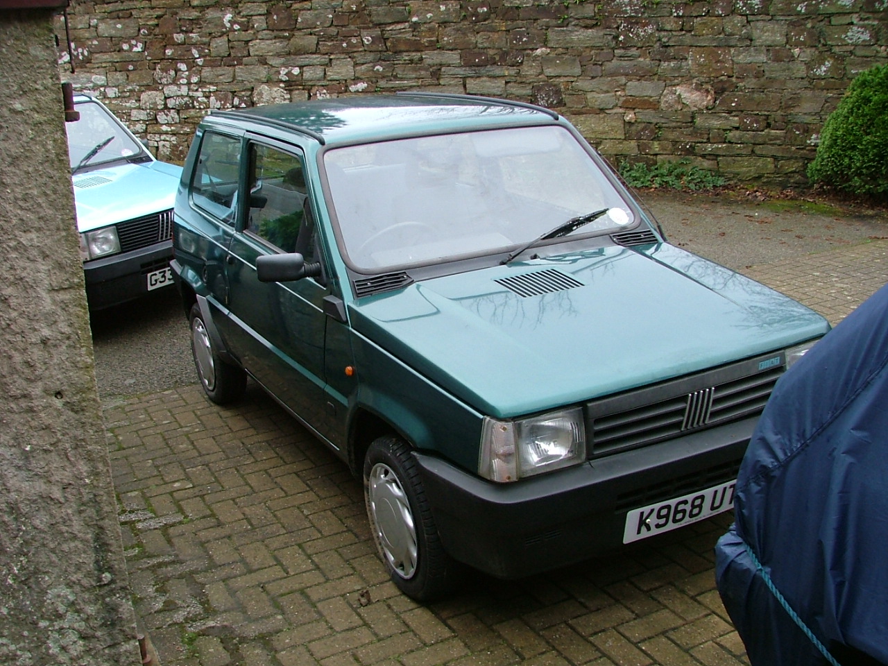

Here's a pic of the unusual sump guard:
Whisps from the exhaust will most likely ( in this case ) be build up of unburnt fuel passing through the system, caused by the incomplete ingnition created by the faulty lead/leads. If you are lucky, this should clear up after a few miles ( Italian tune-up ? ) If you are unlucky, the unburned fuel will have damaged the inside of the CAT. You will not know for sure until the next emissions test is done.
Rgds.
The sisleys green is tropico verde.
I've seen those sump guards on all 1000 fire pandas that have the catalytic converter in front of the engine, (in Holland.)
