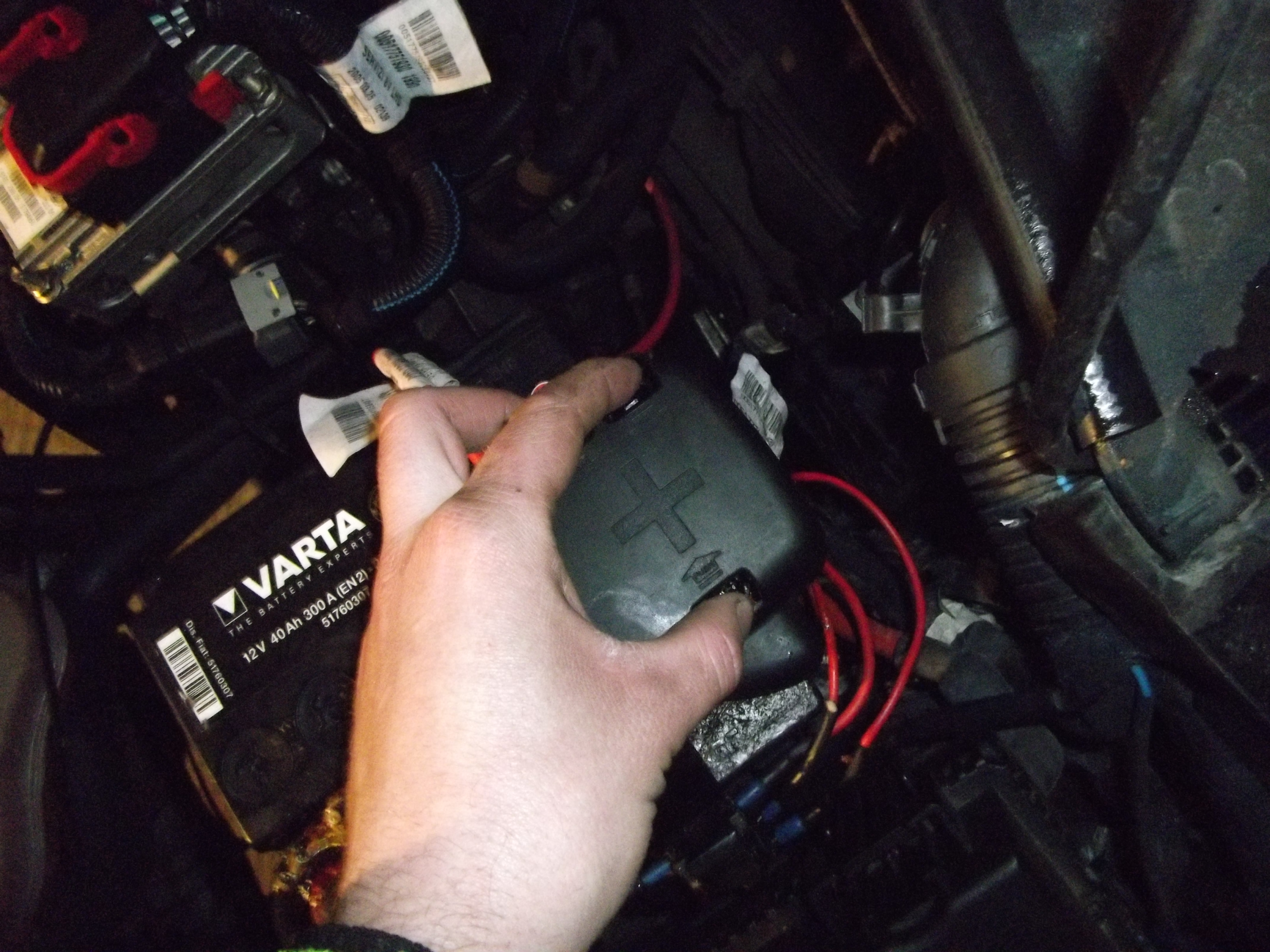

now remove the plastic cover off the live post by squeezing the three tabs together
and pull off and place out of the way
