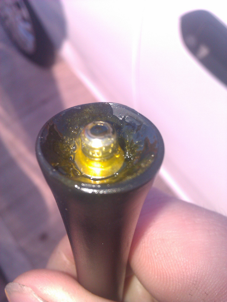

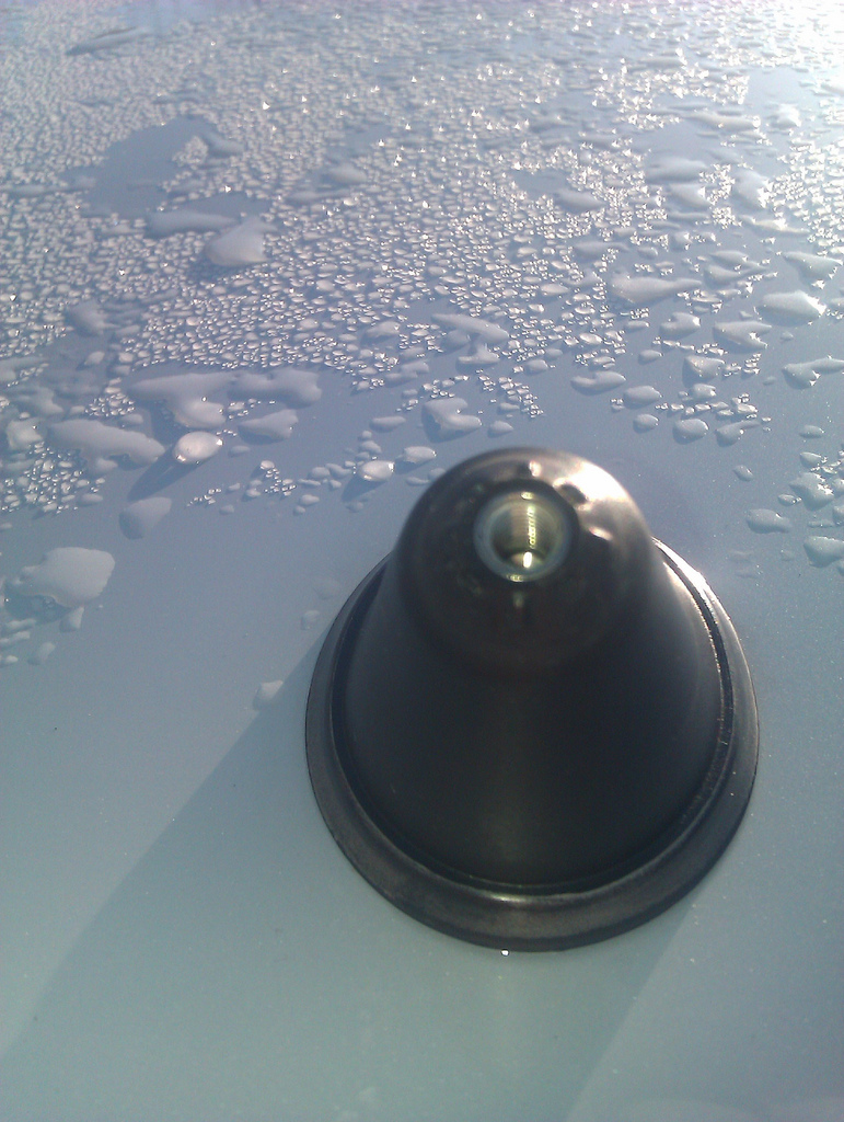

They are M5 (5mm) (just been out and wound an M5 nut on mine to check then double checked the base with an M5 plug tap.....
(bit of grease on there but you can see the thread
and your base should look like this
just wonder if its been snapped off and you have been left with the remaining stud off the antenna stuck in the base?

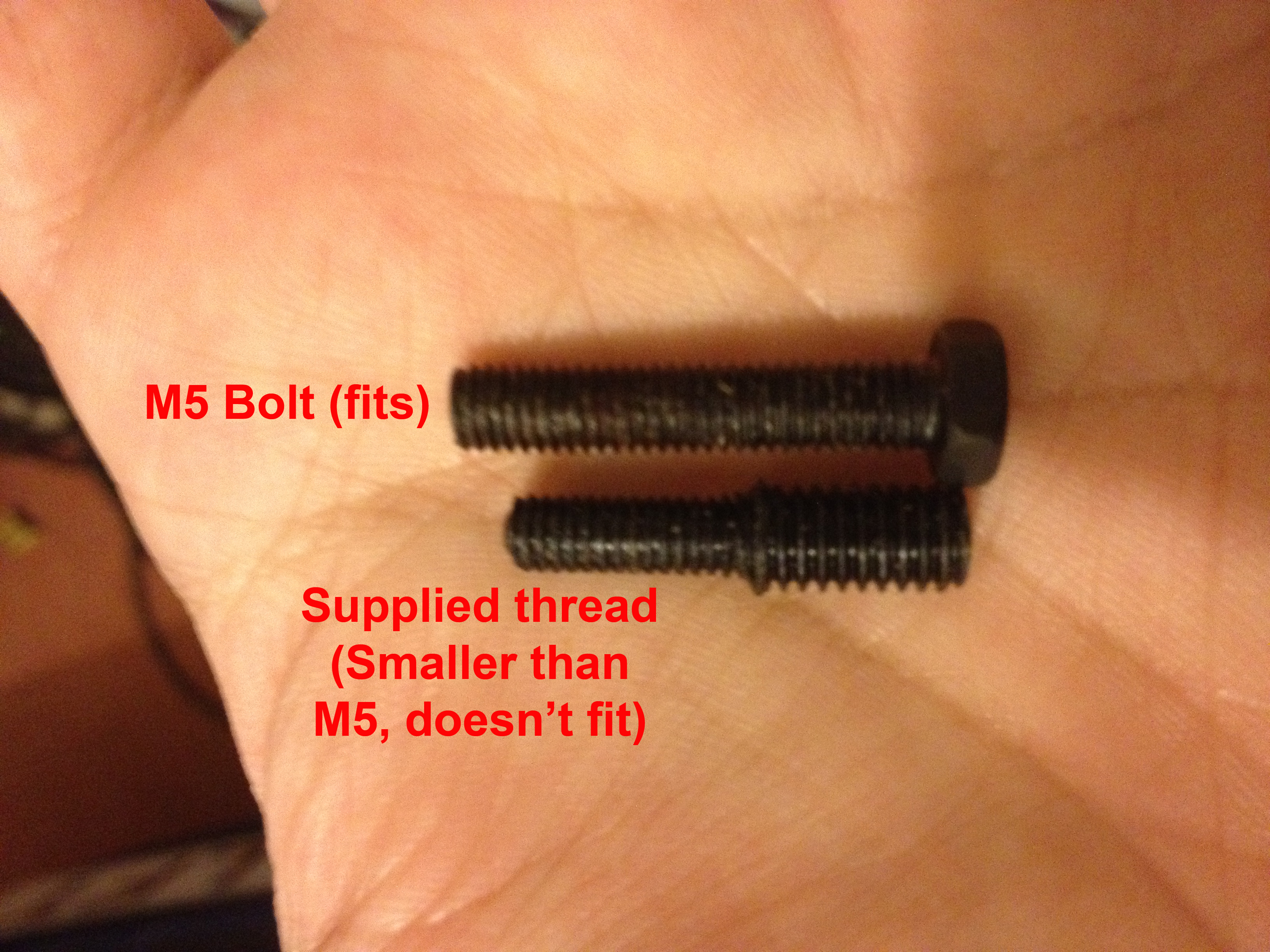

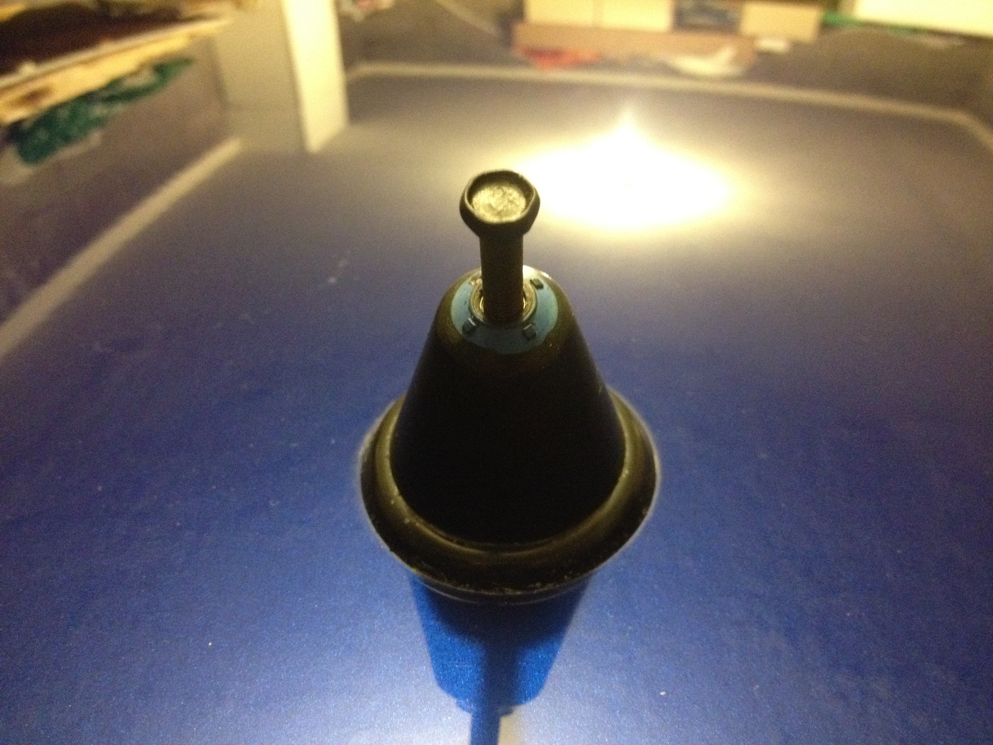

Thanks Andy, great idea using an M5 bolt to check. First I had a look in the base, all seemed well so I tried screwing in an M5 bolt I had lying around in the garage, luckily it fitted! You had me worried :p
By the way the car's not dirty that's the reflection of the artex ceiling in the garage!
Anyway once I took this bolt out, I compared it to the thread I got with the new aerial, and it's smaller than M5, but bigger than M4 :bang: So I'll be sending this picture to the seller and asking for a refund.
Moral of the story is don't buy cheap and cheerful

It's an M6 thread that goes in to the aerial otherwise I would have done that. I'll just return it and buy a better one that hopefully fits.
