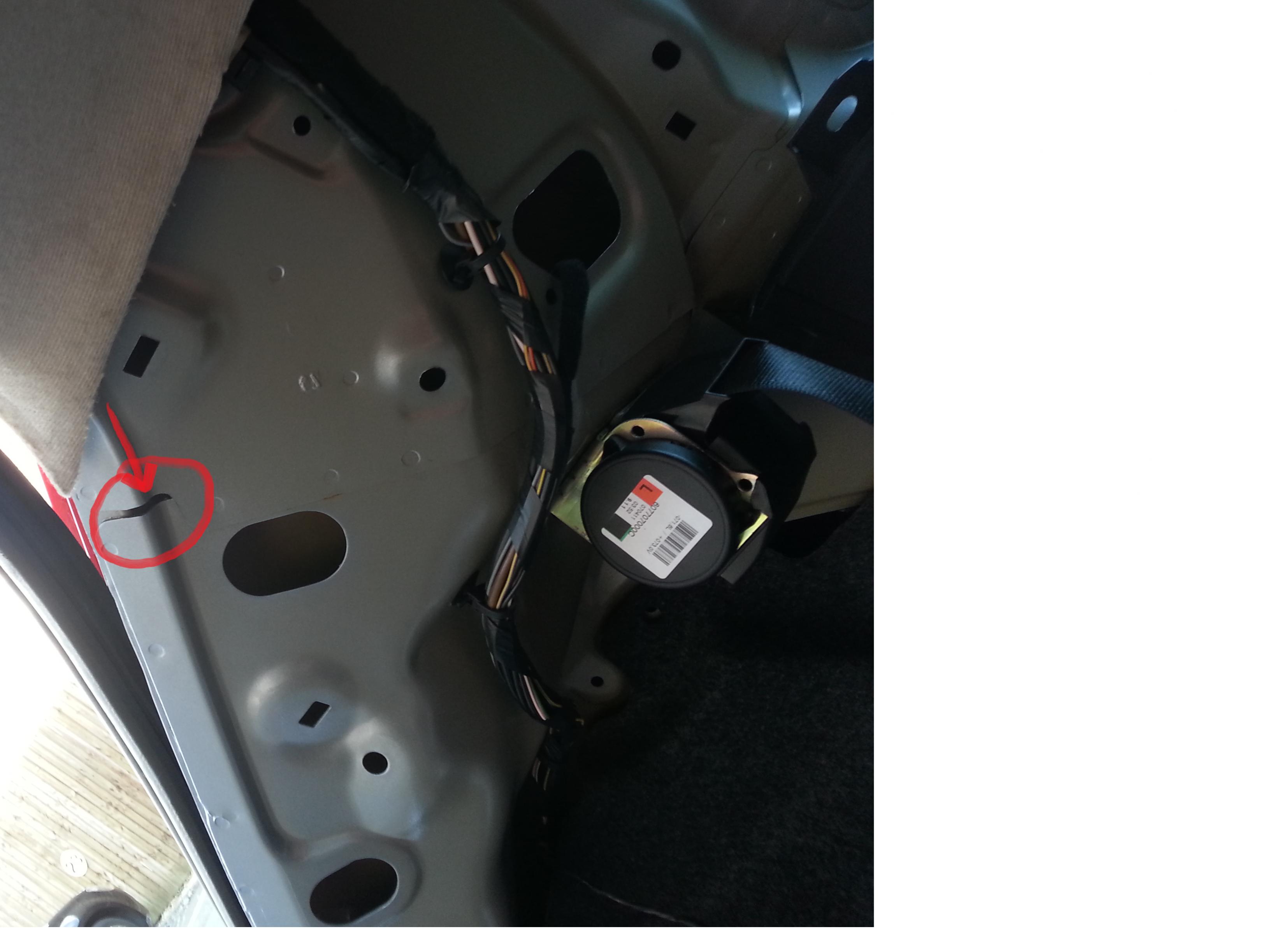

I have added a picture to show to were its running into the car from but carn't see were it enders as its comming from behind. And I know its high up just below the roof lining but the roof lining is bone dry.
I have circuled were the water is comming in from it is also running down the inside of that panel and leaking through the seatbelt bolts.

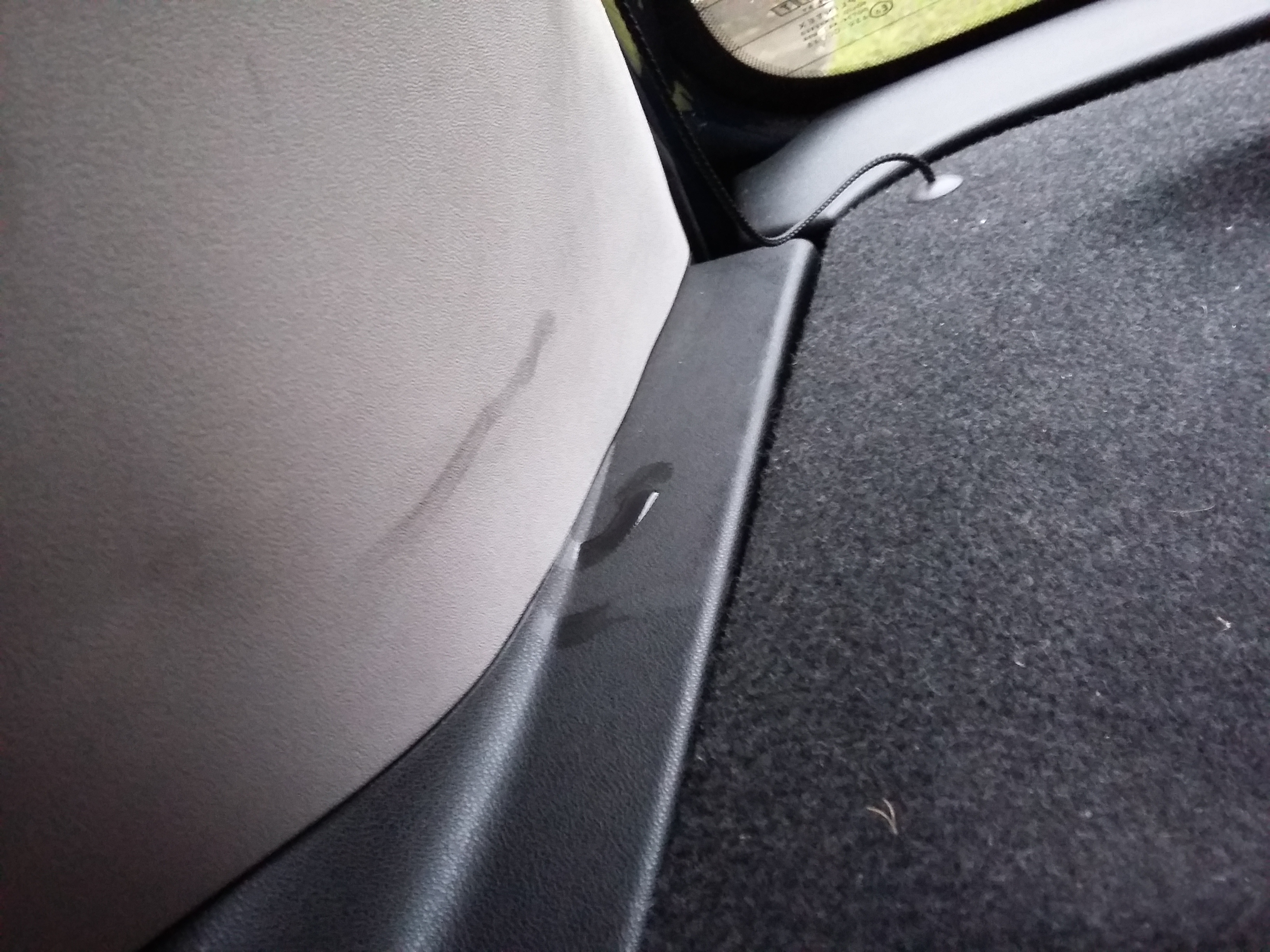

Having the exact same problem!! But the leak is on both sides. Checked aerial mounting and no leak coming in from there. Please any suggests. 100% not the lights, I've already put silicone on n sealed them with no luck.
The leak also fills my tailgate up n causes water to leak into the lock which has caused that to stop working too

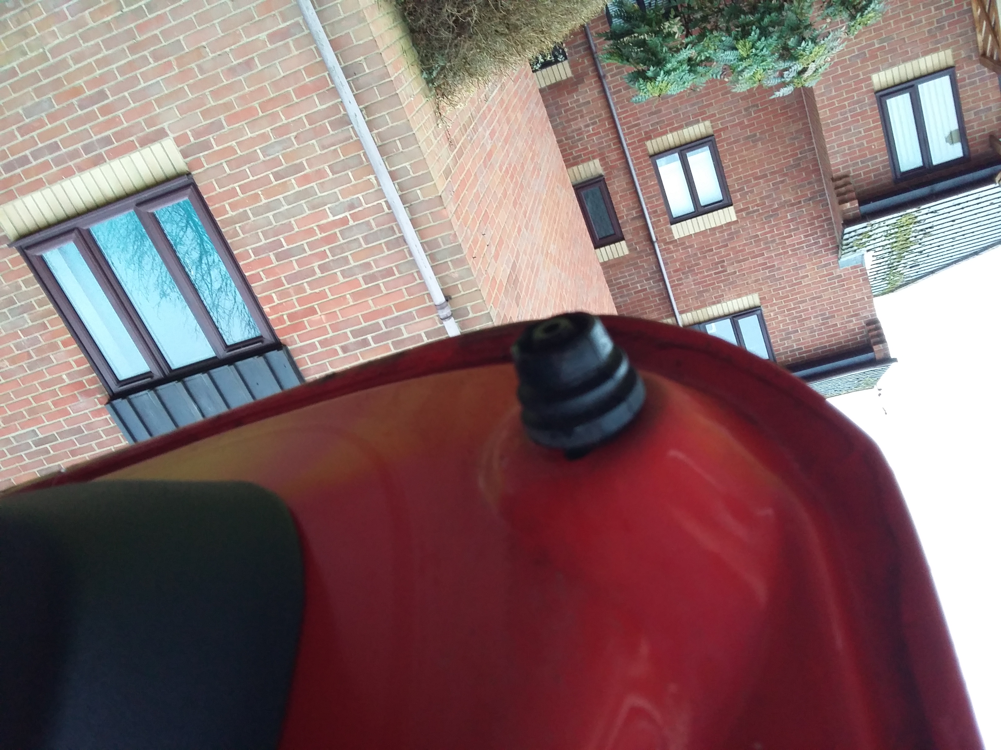

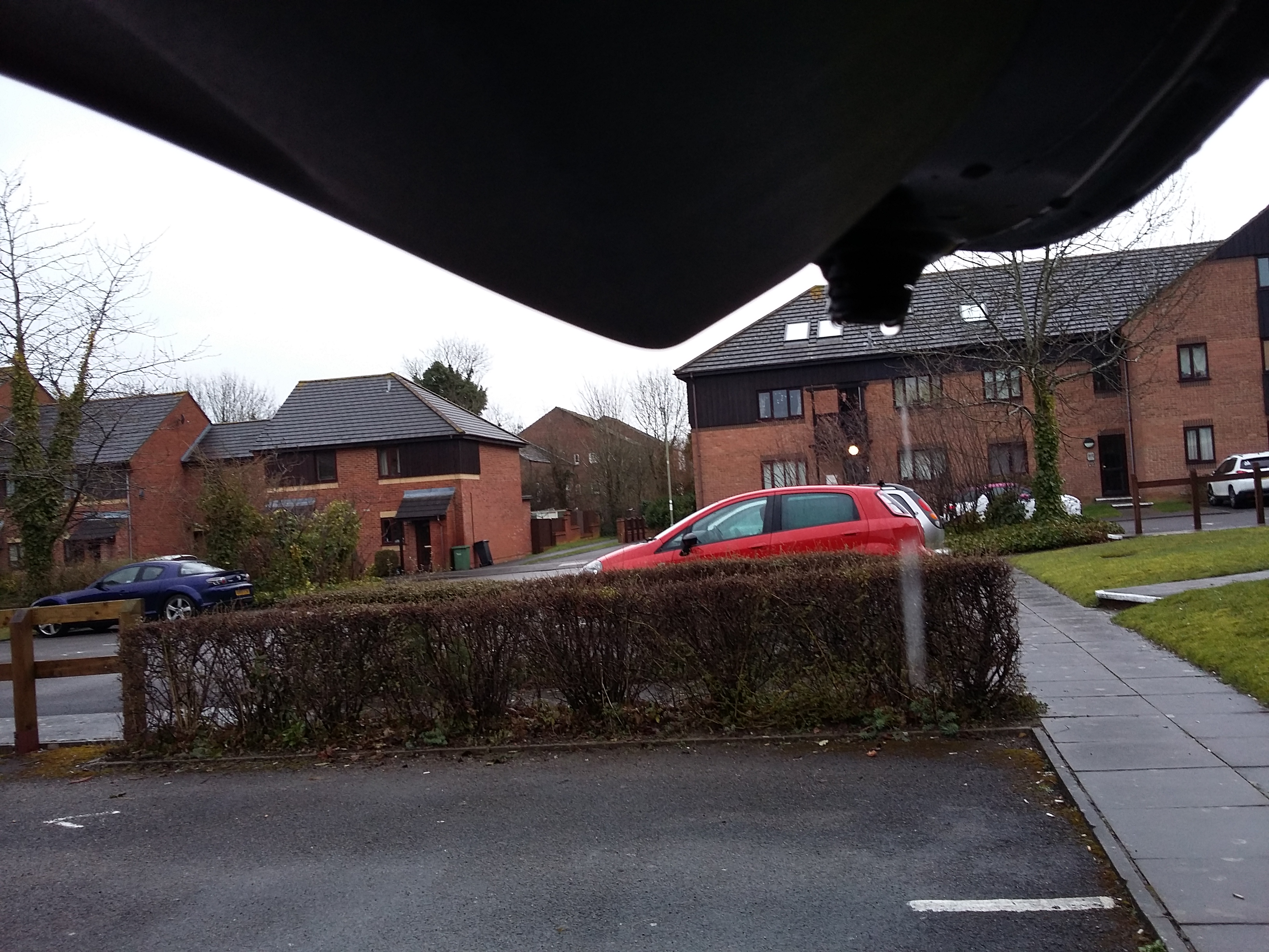

Tip:
When the tailgate is half open..so Horizontal.. water should run from the rubber bumpstops in the corners
All the tailgates collect some water.. that is their nature..
But to fill the lock.. maybe it is pouring over a lip.. and them filling the boot
Tip:
Ok didnt know that, at least that's normal, I'm going to leave it till next week now as I got the whole week off work, in prepared to spend a day with the hose pipe on the roof to find the source of entry. I will return with either pictures and a solution.

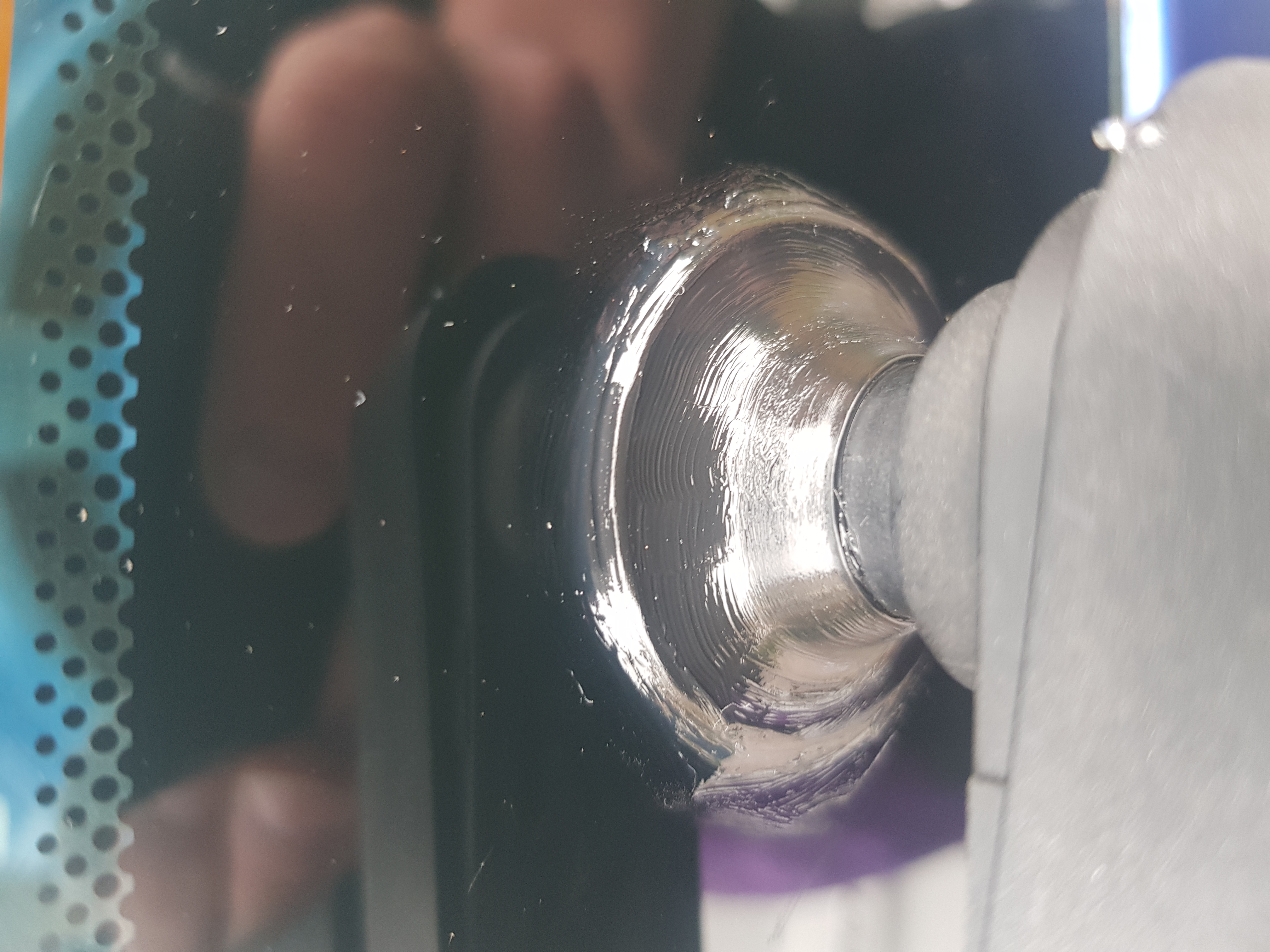

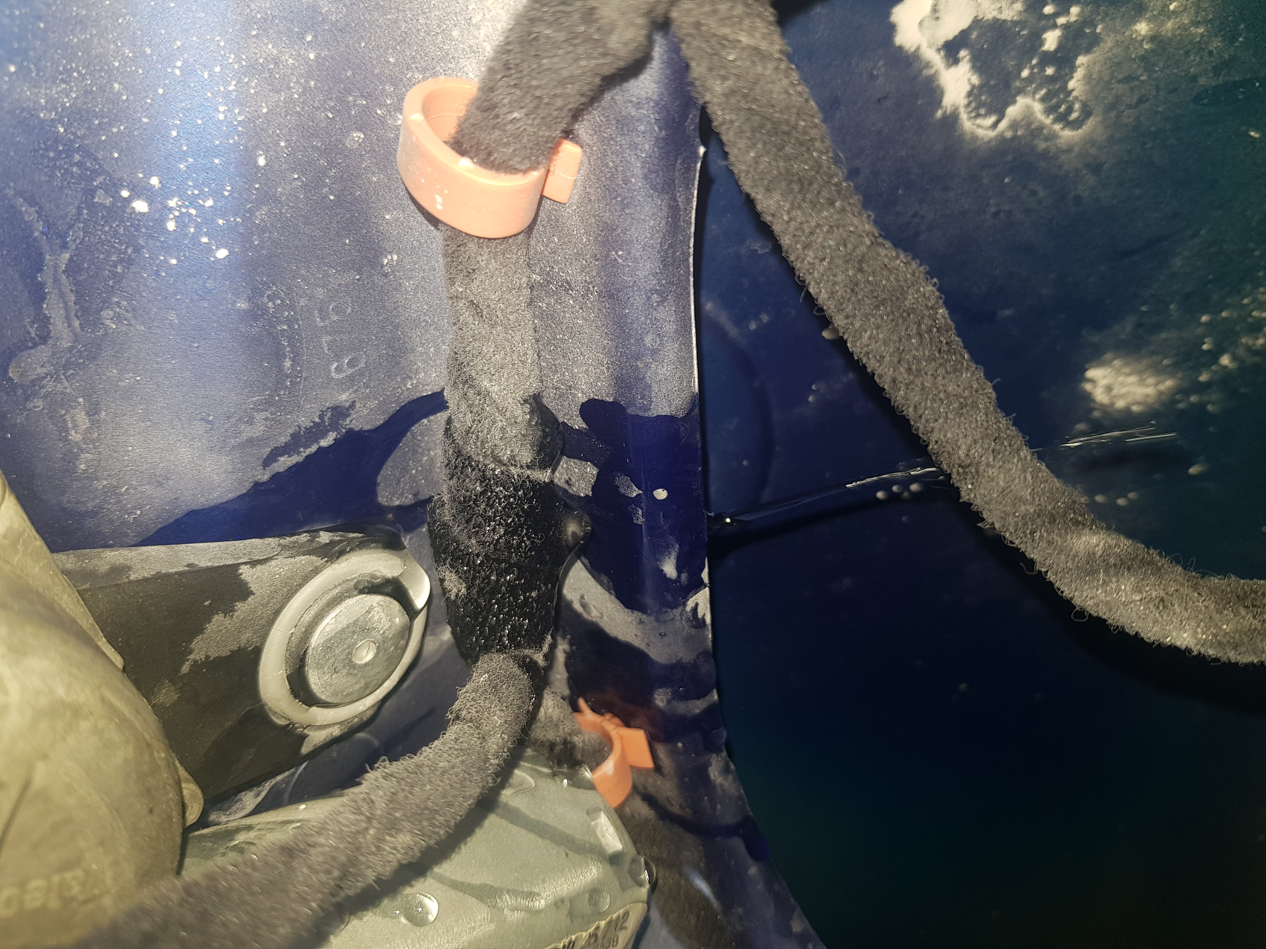

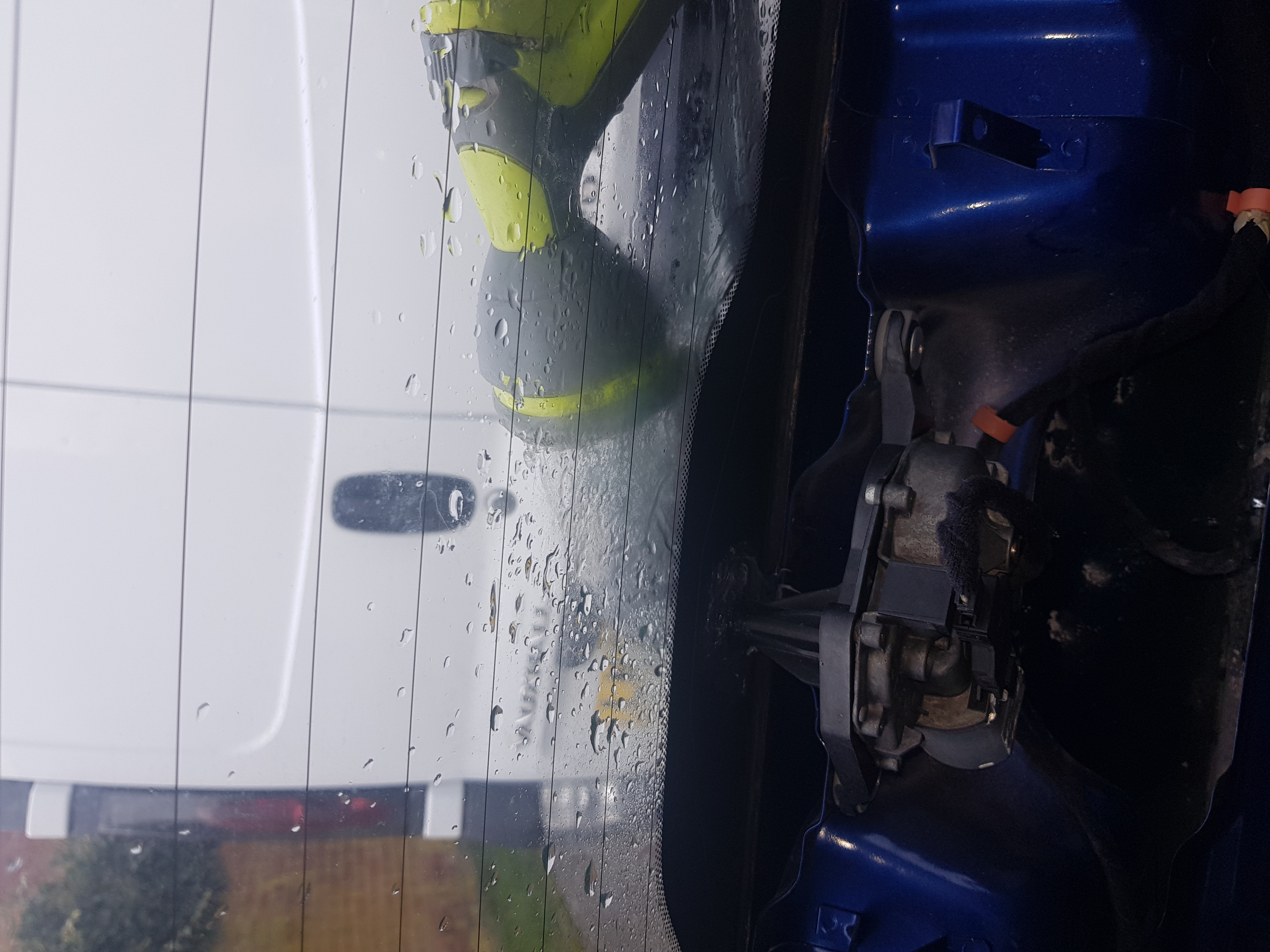

So quick update like I said I would.
Found the boot lock leak by placing the hose directly over my wiper motor. left it 2 minutes and found it pissing in as you can see from the photos. All that water was dripping directly into the boot locking latch that I temporarily to removed.
I've tried soliciting inside but was very hard and messy and it failed. So I've now done a half neat silicon job on the outside rubber and again you should see that in the photos. Moving onto the two side leaks tomorrow.
