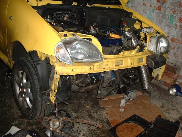

its only off the road for a while because he's lazy. It just needs a new radiator, fan and some bumper clips
look at the poor thing!
