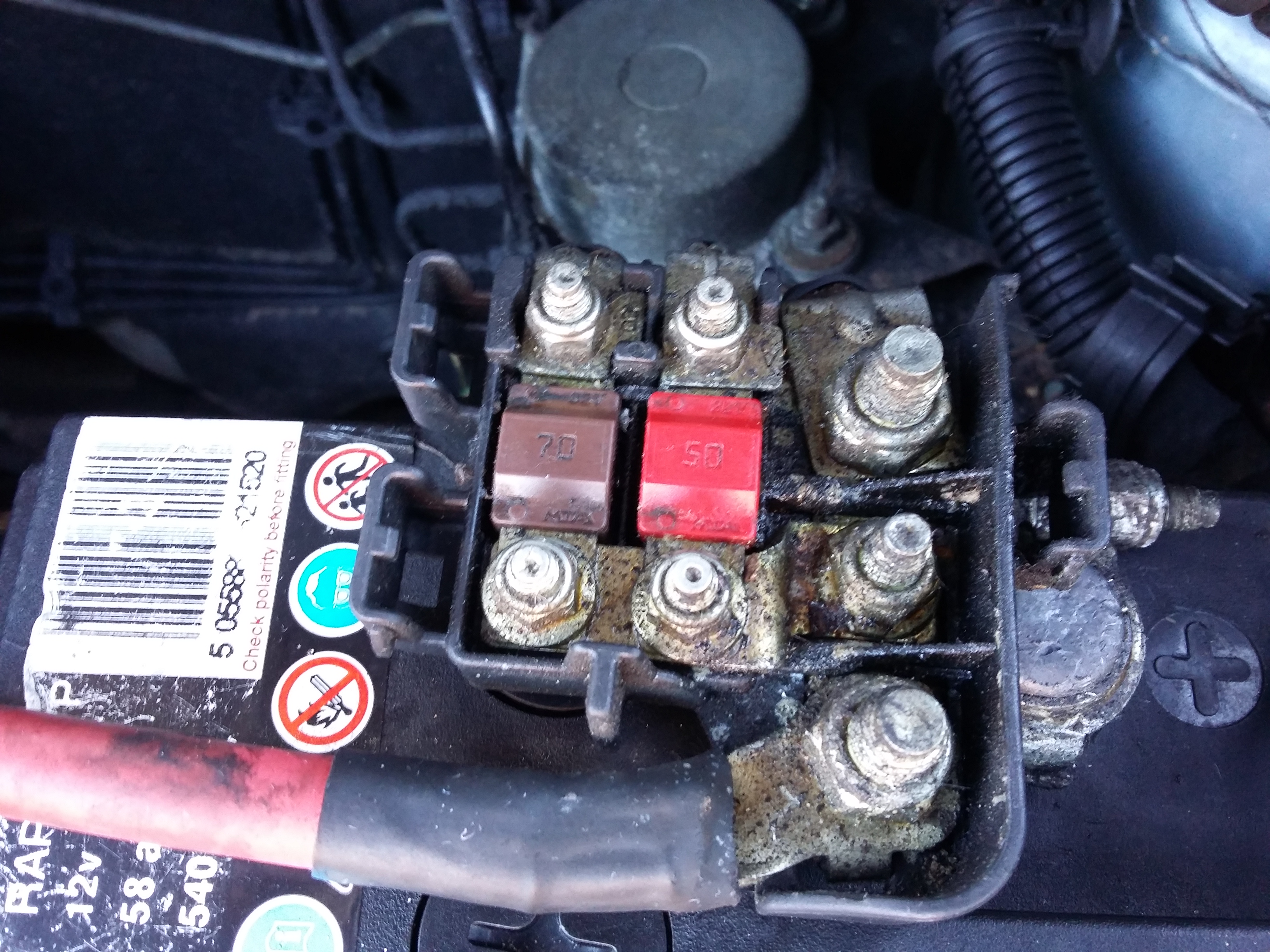

Check the MAXI fuse
It is at the battery terminal. ;)

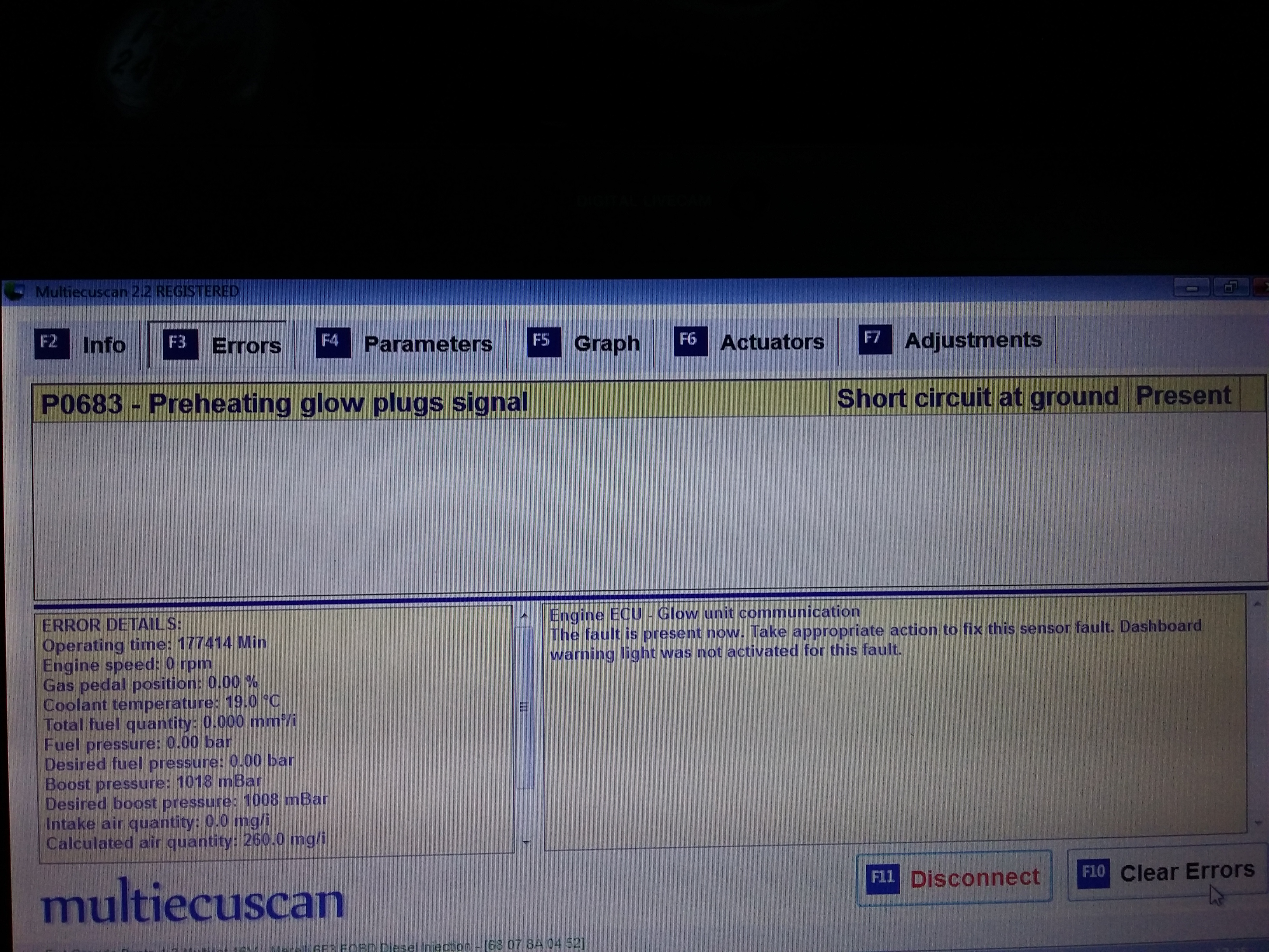

My '07 mj had this.. blown after a shorted plug.
I used household fusewire..
See my thread about it:)

These are the fuses..
They are not stovked that often.. so ..
As the car wouldnt start without..
I walked to a hardware store and bought a little pack of household wire.
