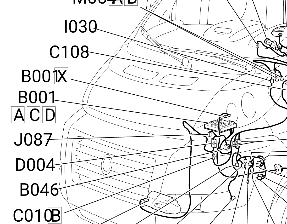

This is actually helps recognise relays etc so get the codes and look on the fiat downloads
