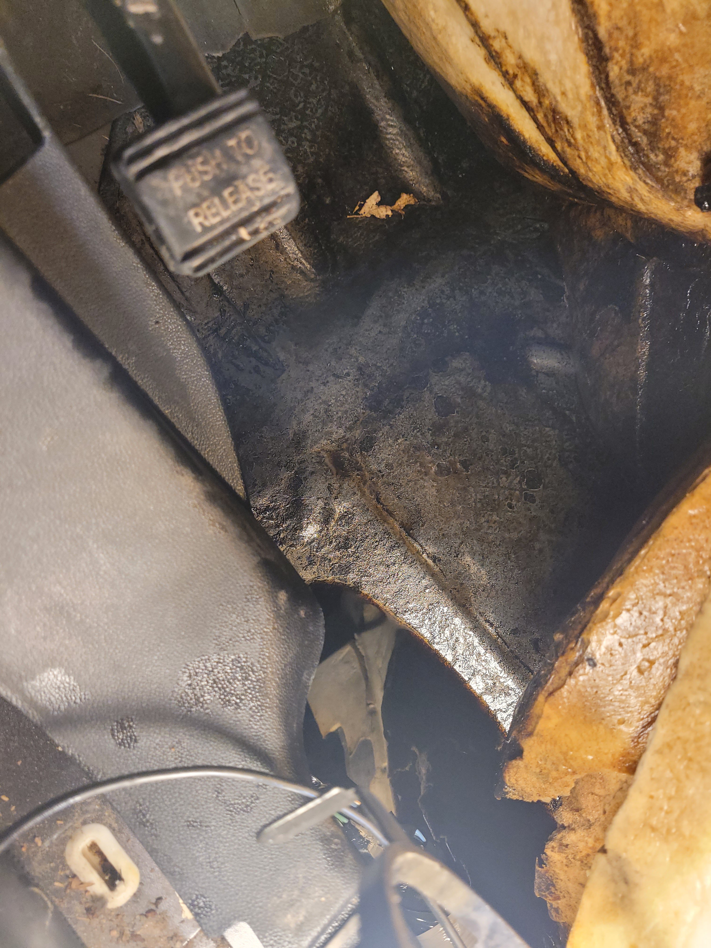

Hi everyone.
My daugter have a 2015 Fiat Freemont and its been leaking diesel from underneath of the car.
I picked it up today and drove it into my garage in order to check it out.
I noticed a odour of diesel and i discovered that its been leaking fuel into the coupe, under the carpet on the driverside.
The carpet is soaked with diesel🤒
Anyone got a clue where it may come from?
I cant see any fuel line on the floor, they should be underneath i suppose.

Do the fuel lines run through the cabin? A way to check is to follow the flow and return lines from the engine compartment to the rear of the vehicle. Do they disappear from underneath the car to the inside?
