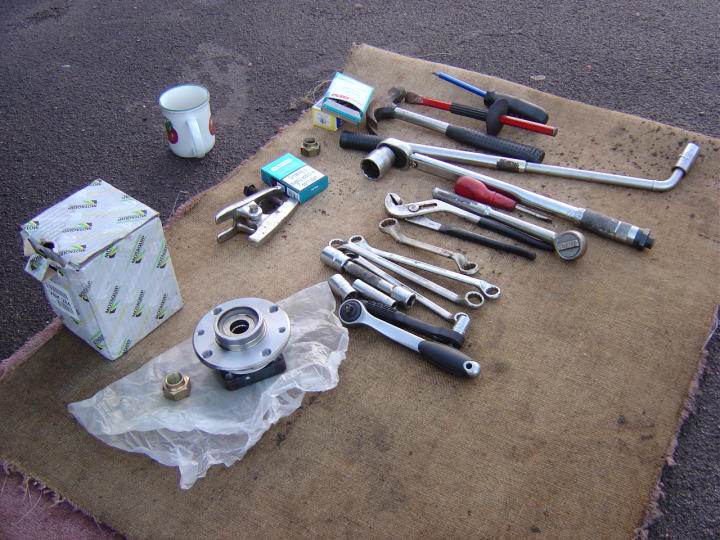

Tools Required:-
  • Torque wrench
  • 32,19,17,13 & long 12mm sockets
  • 19,17,13mm Ring spaners
  • Good quality ball joint removal tool (This is optional as there are two methods of removing the bearing this procedure does not require the ball joints to be removed).
  • Knackered large screwdriver.
  • Small screwdriver.
  • Small or large hammer
  • Axle stand.
  • Plenty coffee if it's cold.
So Sort out your tools (you don't need as many as shown) and your shiny new Hub bearing.
