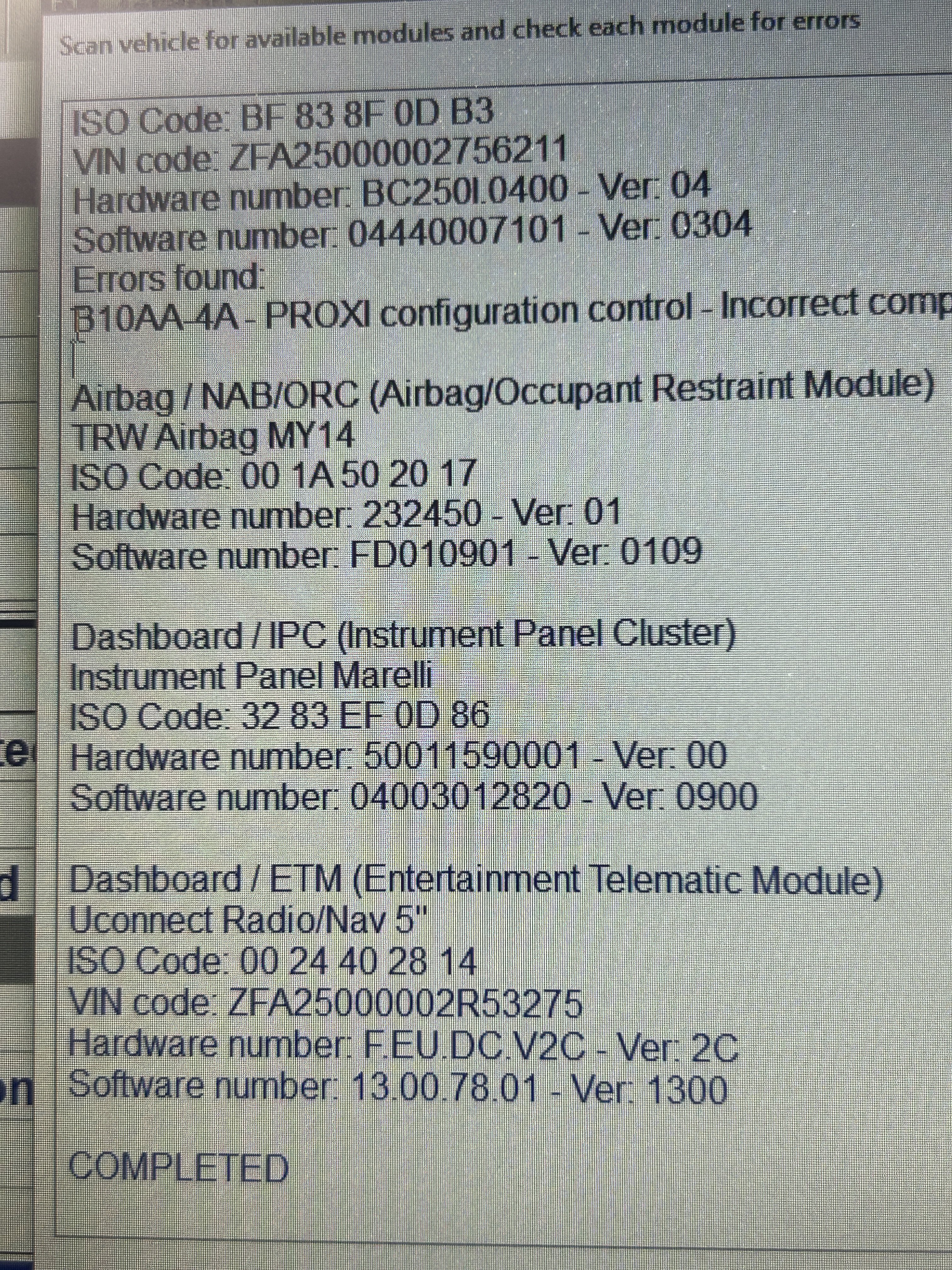

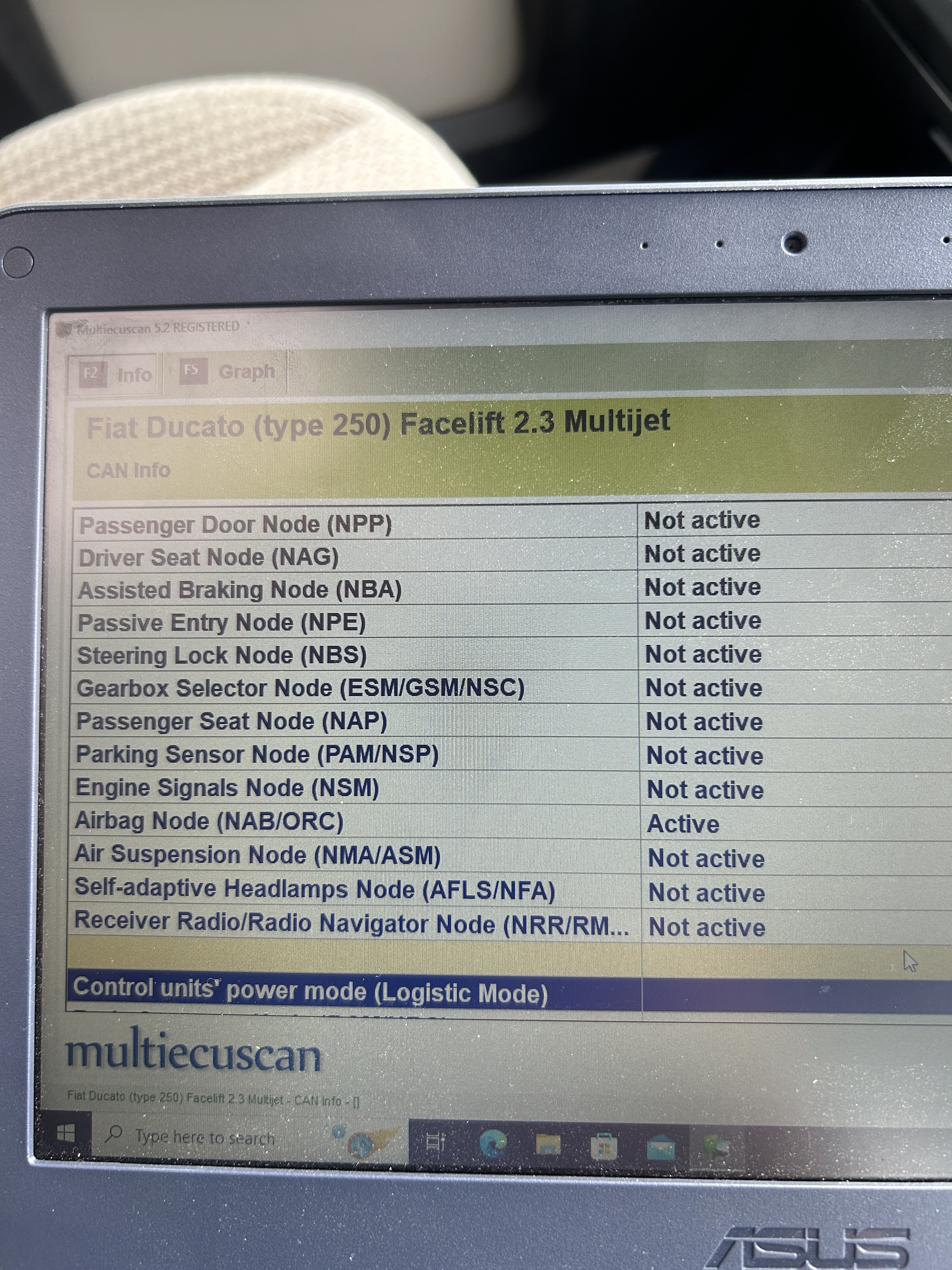

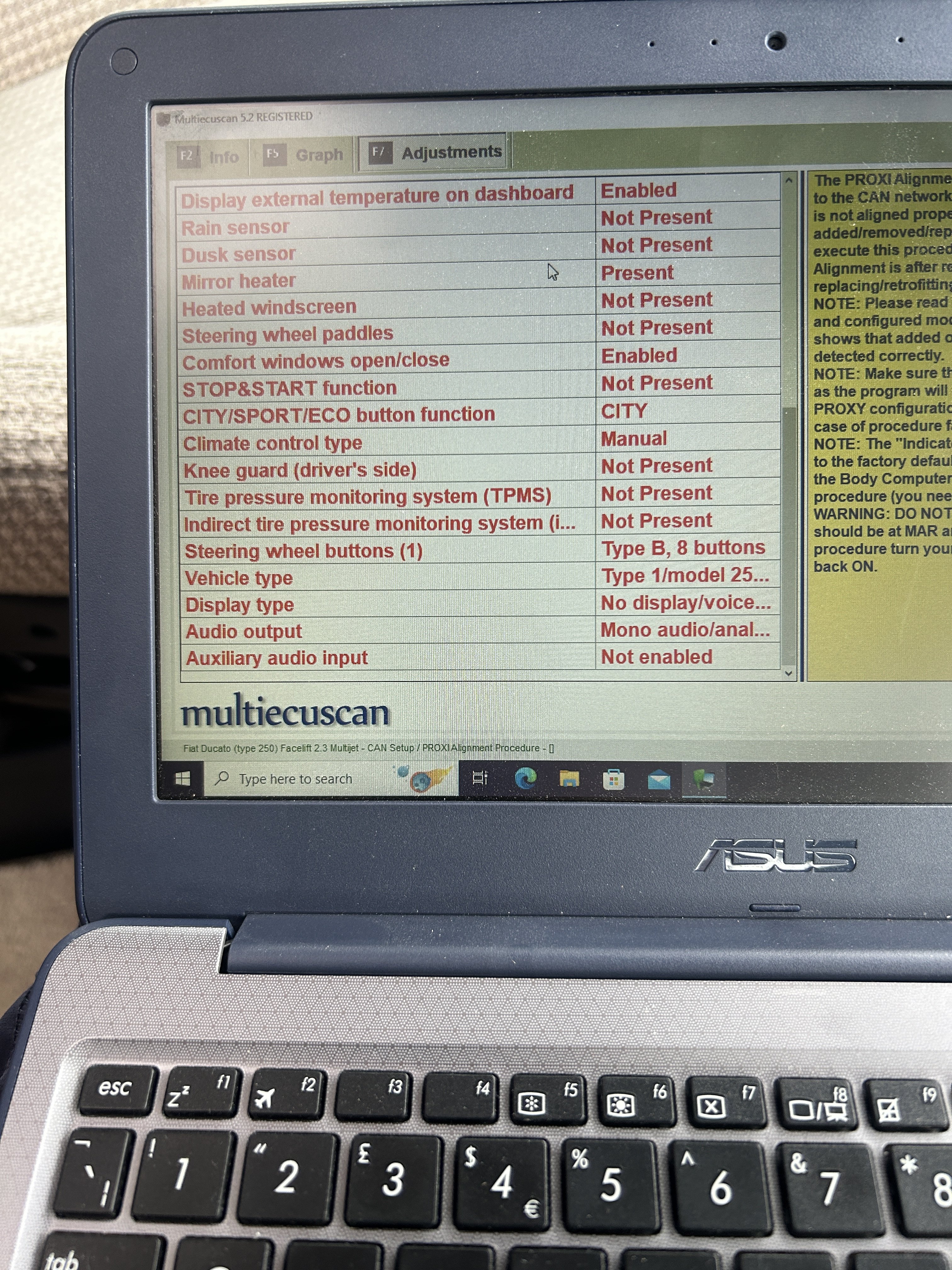

After some help fiat Decato 2015 Had original radio with reversing camera on changed it to a fiat DAB radio Now I have flashing mileage all the time I’ve tried to track change with multi scan tool but can’t all help would be appreciated

Flashing Odometer is result of a failure of the Blue & Me or of power system. The later could be poor battery, IBS or alternator fault or just poor earth. How since you have changed the radio, it recognises that it not there? Suggest you need to disable the blue and me, run an alignment, rescan for devices and re-enable, then re run proxi alignment. Worst case Radio should still work and Odometer stop flashing even with the Blue and me discounted/disabled. You will be a far more experienced MES user by the end. ( you should be able to upgrade to 5.4 on your current license)
To create a new proxi file (once you have changed things that need a proxi alignment). For example changing an airbag module. Prior to any proxi alignment it is advisable to create a backup first. See guide...

You basicaly have to tell the system you have a new radio. If it doesnt work straight away remove both radios try agin . If no flashing then add dab and then proxi align again. It all works then back up proxi file.
