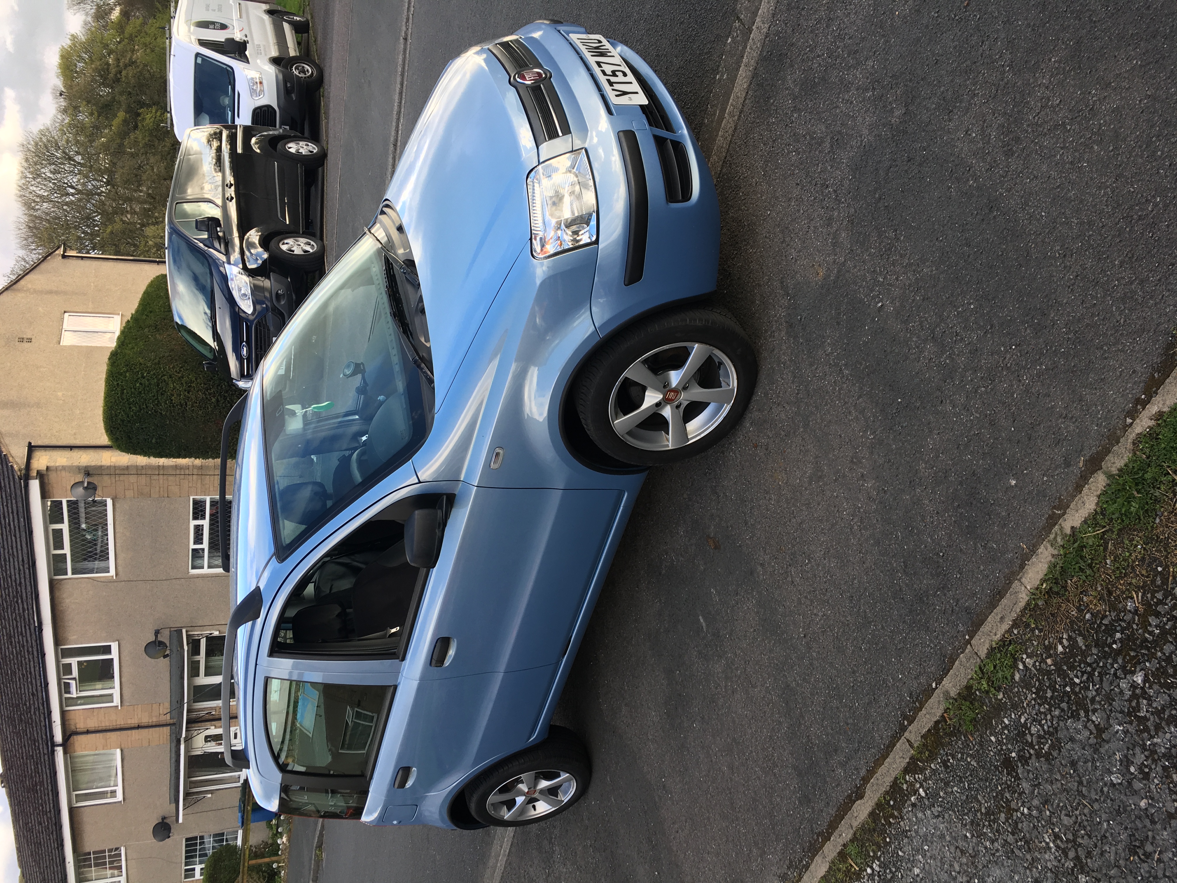

Okay so I got the wheels for a decent price and ordered some spacers and extender bolts to compensate for the additional offset. Fitted a wheel and tried it and the wheel got stuck after about a quarter turn. It was my assumption that the extender bolt was too long, even though I was able to tighten the wheel up properly on the outside. Is there a set length limit for bolt threads before the prevent the wheel from turning?
Anyways I measured the difference between the old and new (even though I was sure I had already measure this correctly before) and have ordered some with a shorter thread to get around the problem. The wheel sat on the car okay and as far as I could tell did not interfere with the arch on full lock, but will need to do a proper test when all 4 are on!

Okay so I fitted the wheels with 16mm hubcentrics and took her out and she rides great. Can’t see any issues or hear any rubbing on the arches at all. Took her around town and over speed bumps too! The wheels are Dezent 195/50R15 with Autogrip F101 radial tyres all round. ��
Success!
(apologies, photo uploaded in wrong orientation)
