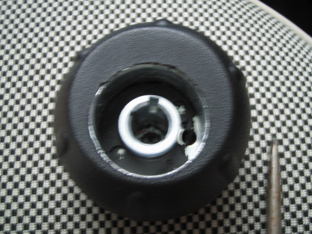

In the instructions is looks simple, screw driver, lever it off and there you go. In reality I found the gear cap (bit with numbers on) is held on by 4 clip joints to the rubber sleeve attached to it. I spent a good 20 mins trying to patiently remove it in tact.
In the end I had to use two screw drivers and leaver it off, summoning the power of Courtney loves rage to detach it. I knew I wasn't going to reuse it so it did get a bit damaged coming off but I couldn't see how you could safely remove it without at least 4 screw drivers an extra pair of hands and a bag full of patience!.

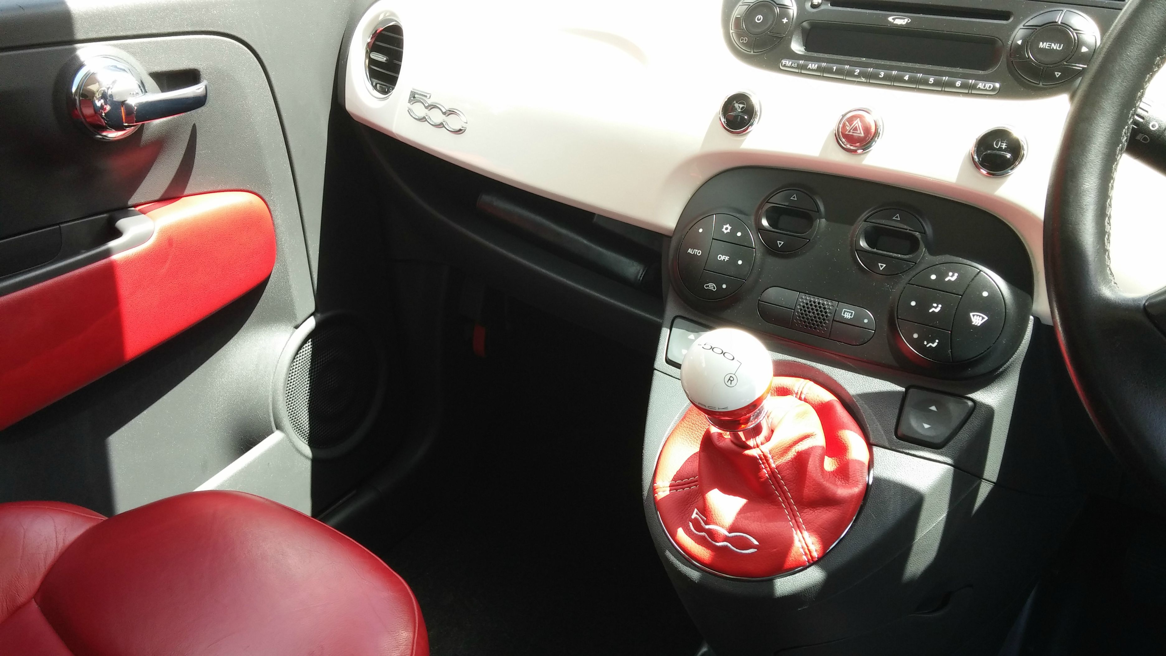

There you have it a newly fitted 500 gear knob.
