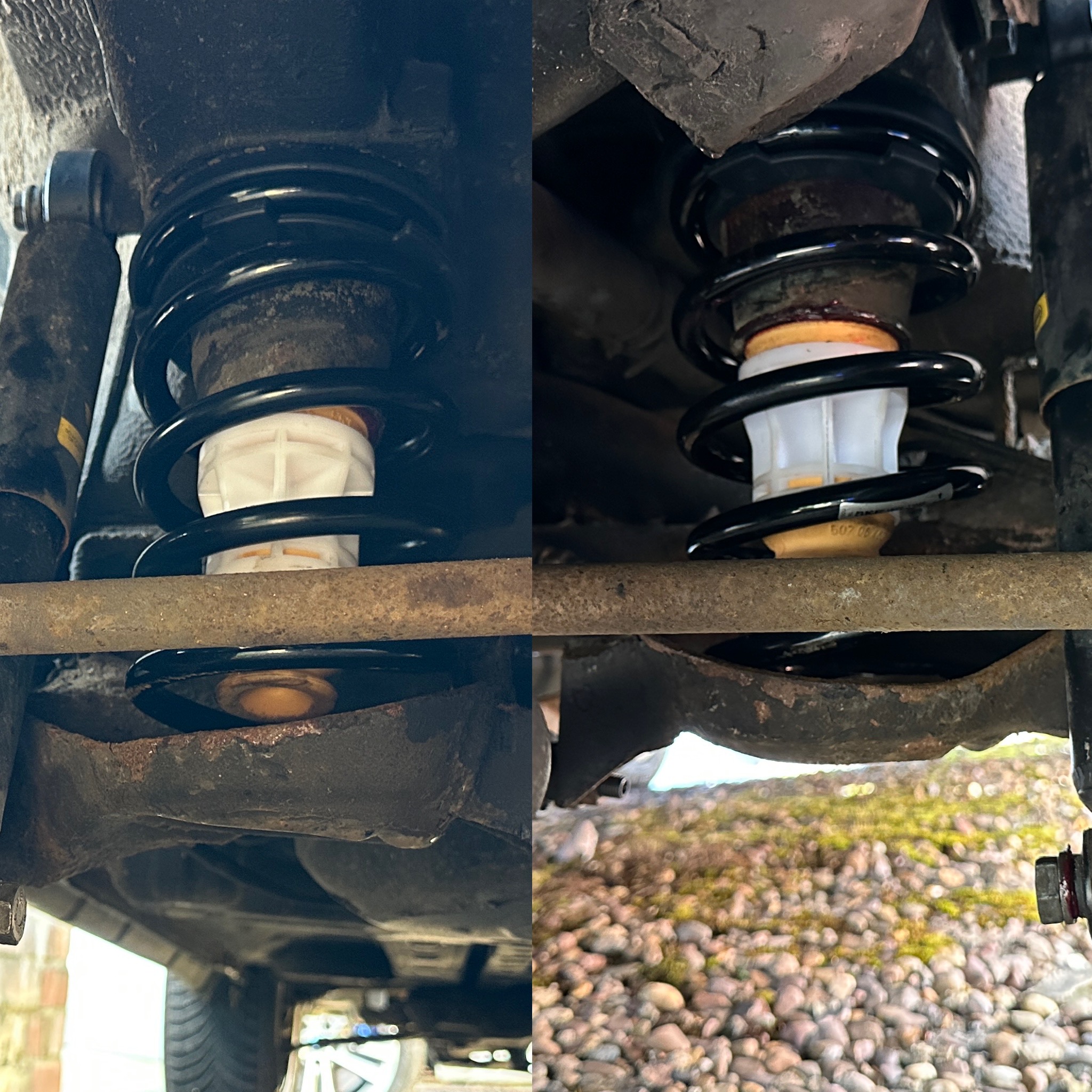

Finally got the new rear springs and bump stops in! I’ve had 3 attempts to do this and just couldn’t get enough movement on the lower mounts to get them out with my stands and jack combination. Even with spring compressors it was not happening 🤬 So decided to let my mechanic do it on his lift at the same time as the MOT. Ninky passed but I now have an advisory to sort out the fronts 🤣
Now with correct bump stops in place you can see how easy it could be to bottom out! I’ll clean up the bottom mounts at the weekend 🤞🏻

Looking good! Gosh, though, those bump stops are long compared to the standard FWD cars.
