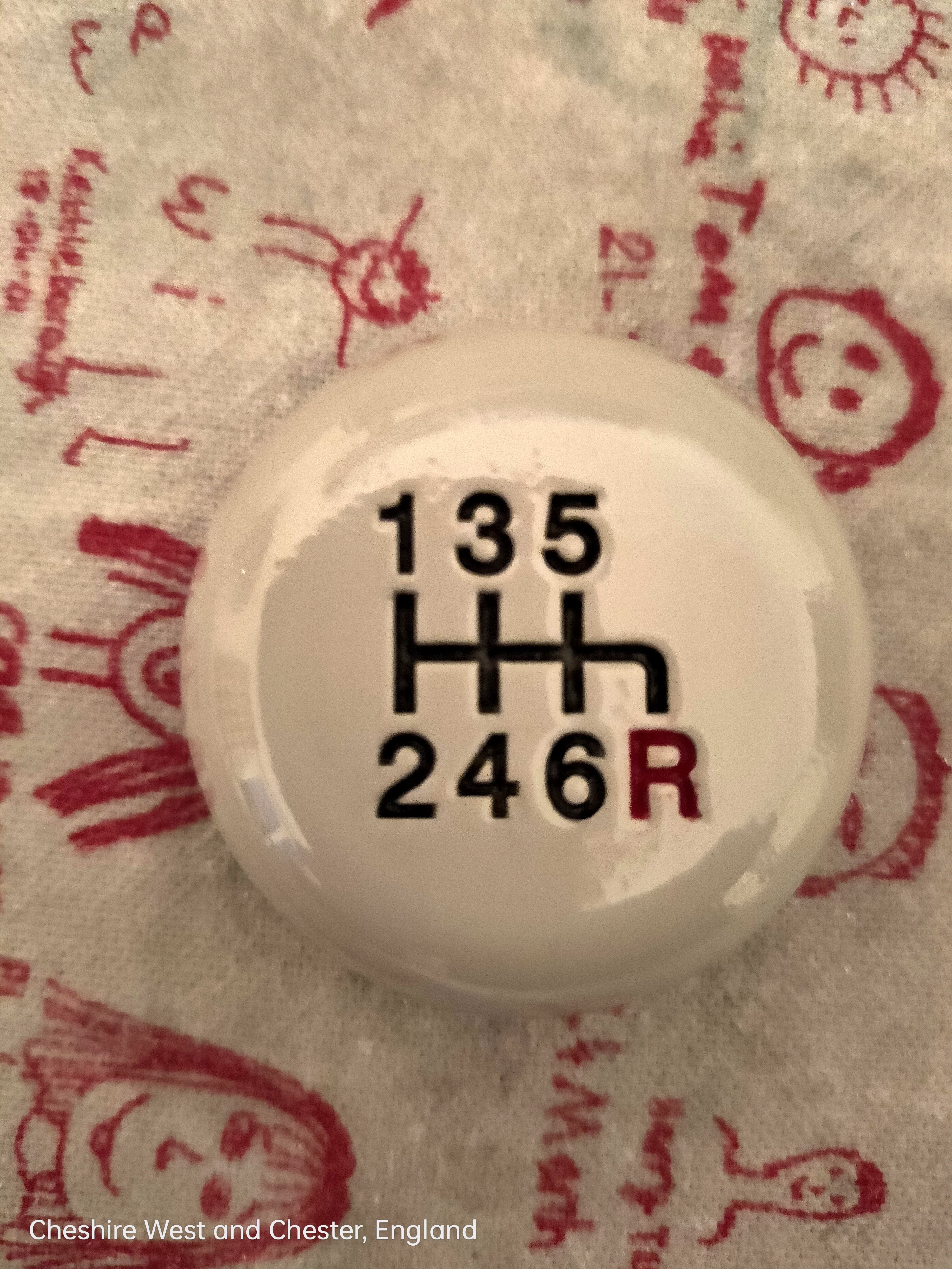

That's looking pretty cool!And now to finesse, already repainted the gear knob and added a BMC Air Filter and its only day 2!
Hi it's really easy. I took the top off the gear stick (simple but careful job easing off and not forcing it). Took the cap back to the light grey it started as (someone had badly painted mine silver), got a needle and scraped out the paint and rubbish inside the numbers. Then for the R used red touch up paint lying around in the garage, and for the numbers a random tin of black hammerite. Dipped the needle (pin) end in the paint and you drop the paint in the numbers/R and drag the pin along to spread it. Any excess you simple wipe off with a bit of kitchen roll and white spirit. Leave to dry for a couple of hours. Then I used Simoniz clear acrylic lacquer (Halfords, £7) applied a thin coat, dried, another 3 coats of apply and dry and hey presto. Cost £7 and dead easy, especially satisfying as you can't buy the top caps anymore. Then just popped it back on.That's looking pretty cool!
What kind of paint did you use? I'd totally screw up, have to drive somewhere at short notice, and end up with paint on right hand!
The contrast of Black, Red, on white looks awesome!
You have MUCH more patience than me!Hi it's really easy. I took the top off the gear stick (simple but careful job easing off and not forcing it). Took the cap back to the light grey it started as (someone had badly painted mine silver), got a needle and scraped out the paint and rubbish inside the numbers. Then for the R used red touch up paint lying around in the garage, and for the numbers a random tin of black hammerite. Dipped the needle (pin) end in the paint and you drop the paint in the numbers/R and drag the pin along to spread it. Any excess you simple wipe off with a bit of kitchen roll and white spirit. Leave to dry for a couple of hours. Then I used Simoniz clear acrylic lacquer (Halfords, £7) applied a thin coat, dried, another 3 coats of apply and dry and hey presto. Cost £7 and dead easy, especially satisfying as you can't buy the top caps anymore. Then just popped it back on.

It would be a disaster if I tried it!Its why I bought the car, someone said "save the Panda" so I am! . Nothing more satisfying than doing something yourself at minimal cost rather than forking out for a lot more. I could have but there'd be no satisfaction in taking the easy route.. have a go, I'm just pleased that it's not a disaster! Plus it was raining on Sunday...
