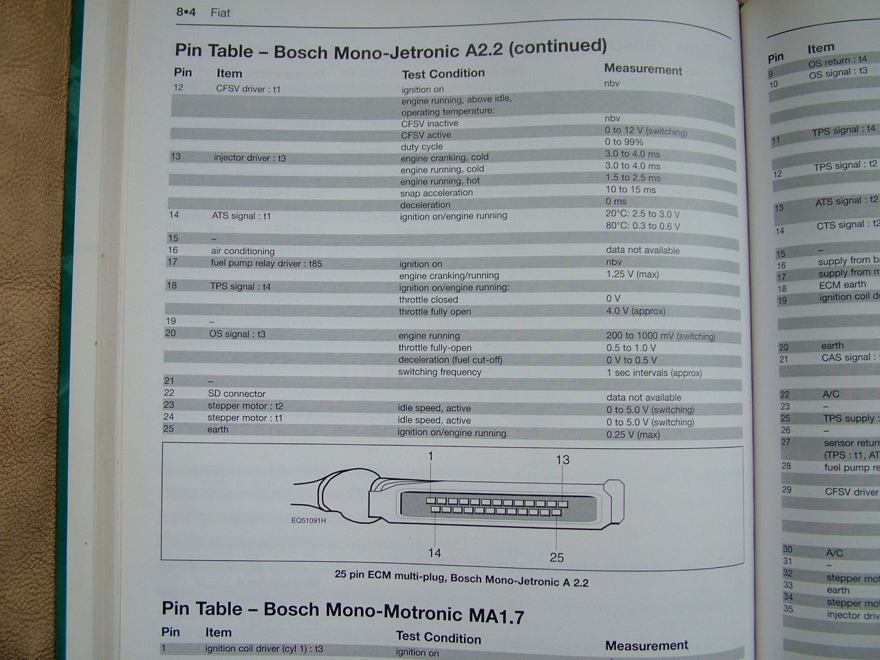

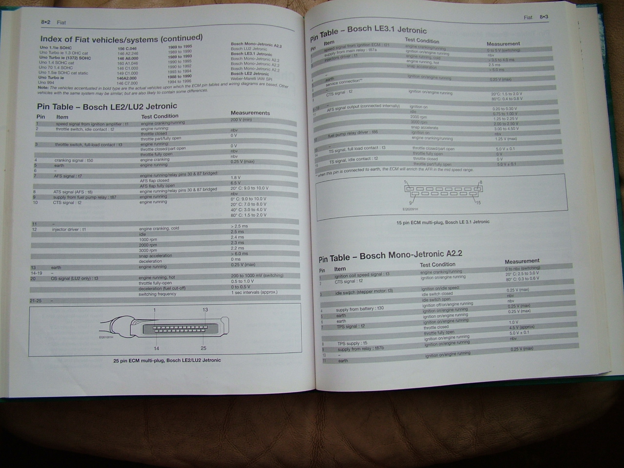

As you say, looking at this manual there is no mention of immobiliser, so all you can do is carry on checking the basics yourself.
If your neighbour or someone more familiar with car electrics is available they may be able to check the details in the photos below.
My instincts are that it is possible a mechanical issue due to previous overheating/loss of coolant as mentioned at the beginning, so bearing in mind you say you have fuel and a spark, compression would be something to check for.:)
