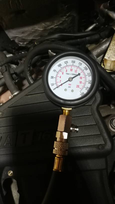

You having oil on the plug and registering Zero compression would be more likely a damaged piston

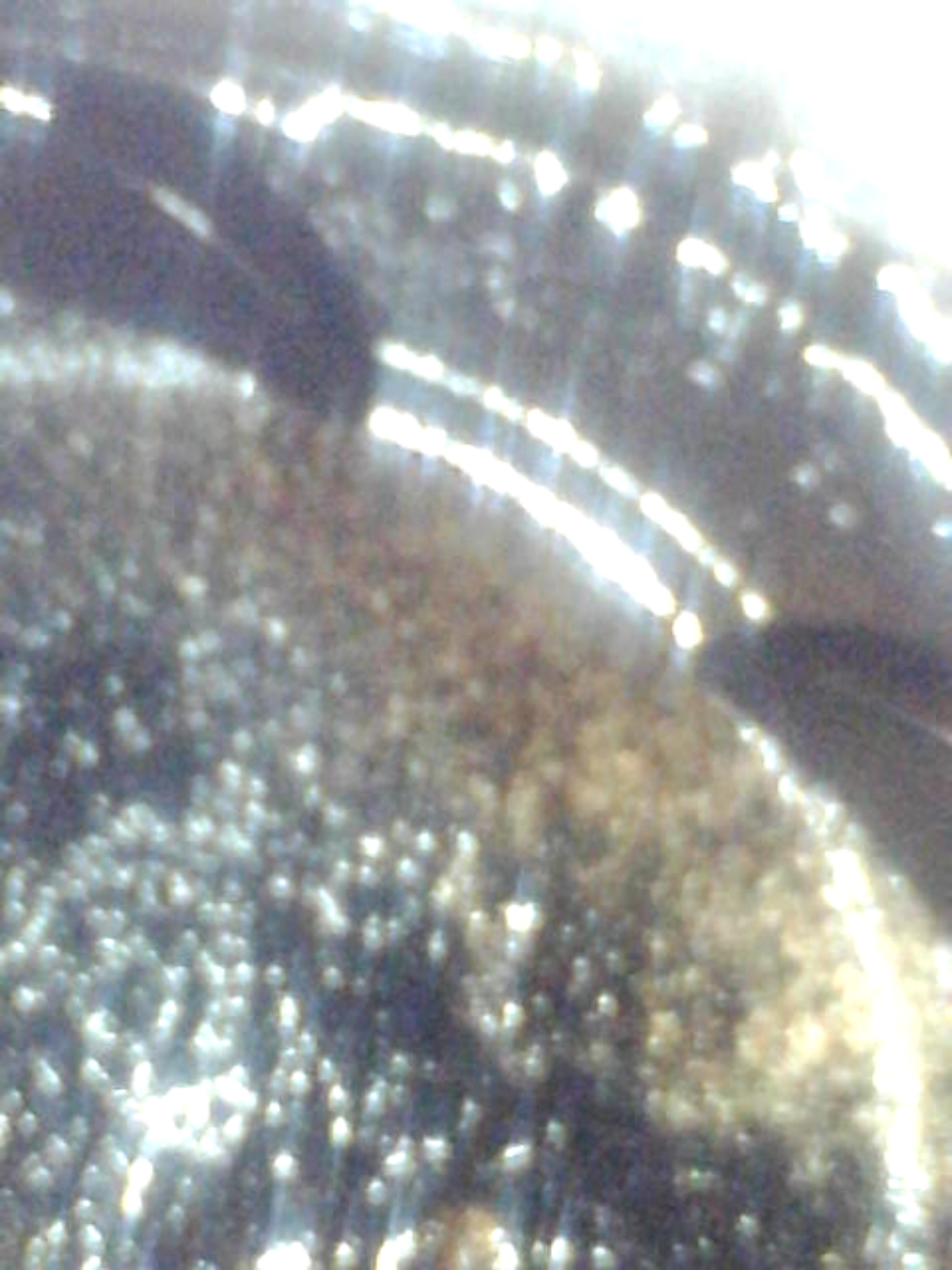

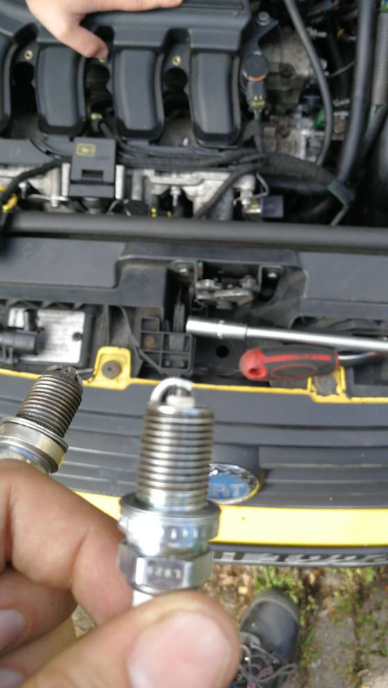

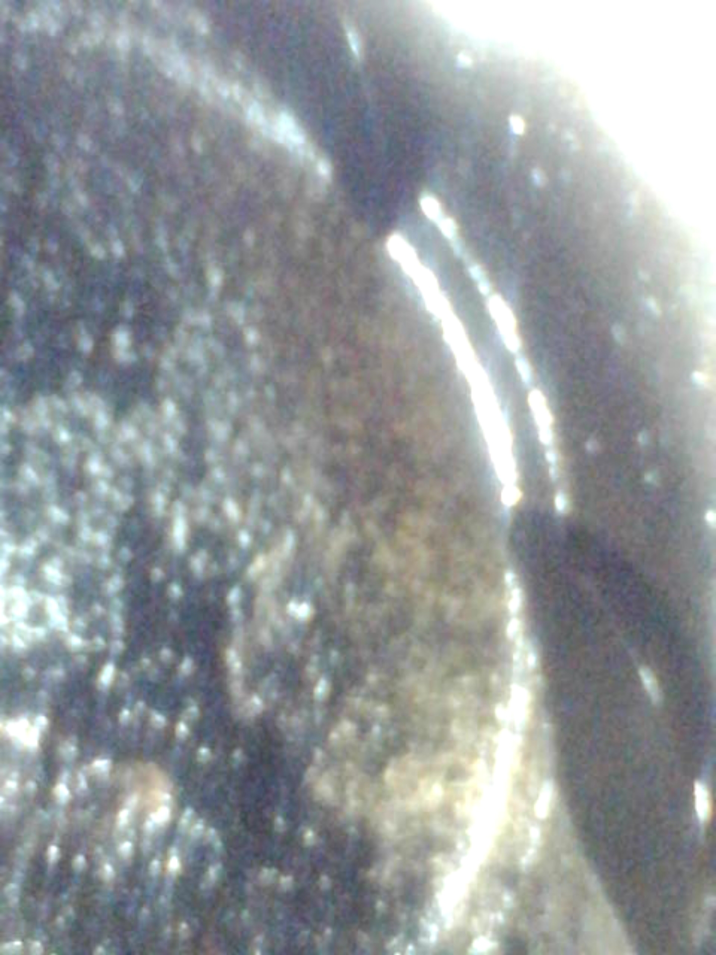

Hello,I did as you said with endoscope, I could not recognize anything, but anyway what I have noticed, that the piston hits the spark plug in cylinder 2.
I changed the plug (its long is 100% right) but piston hits it again.
Here are Fotos....
May anyone helps me [emoji17]
