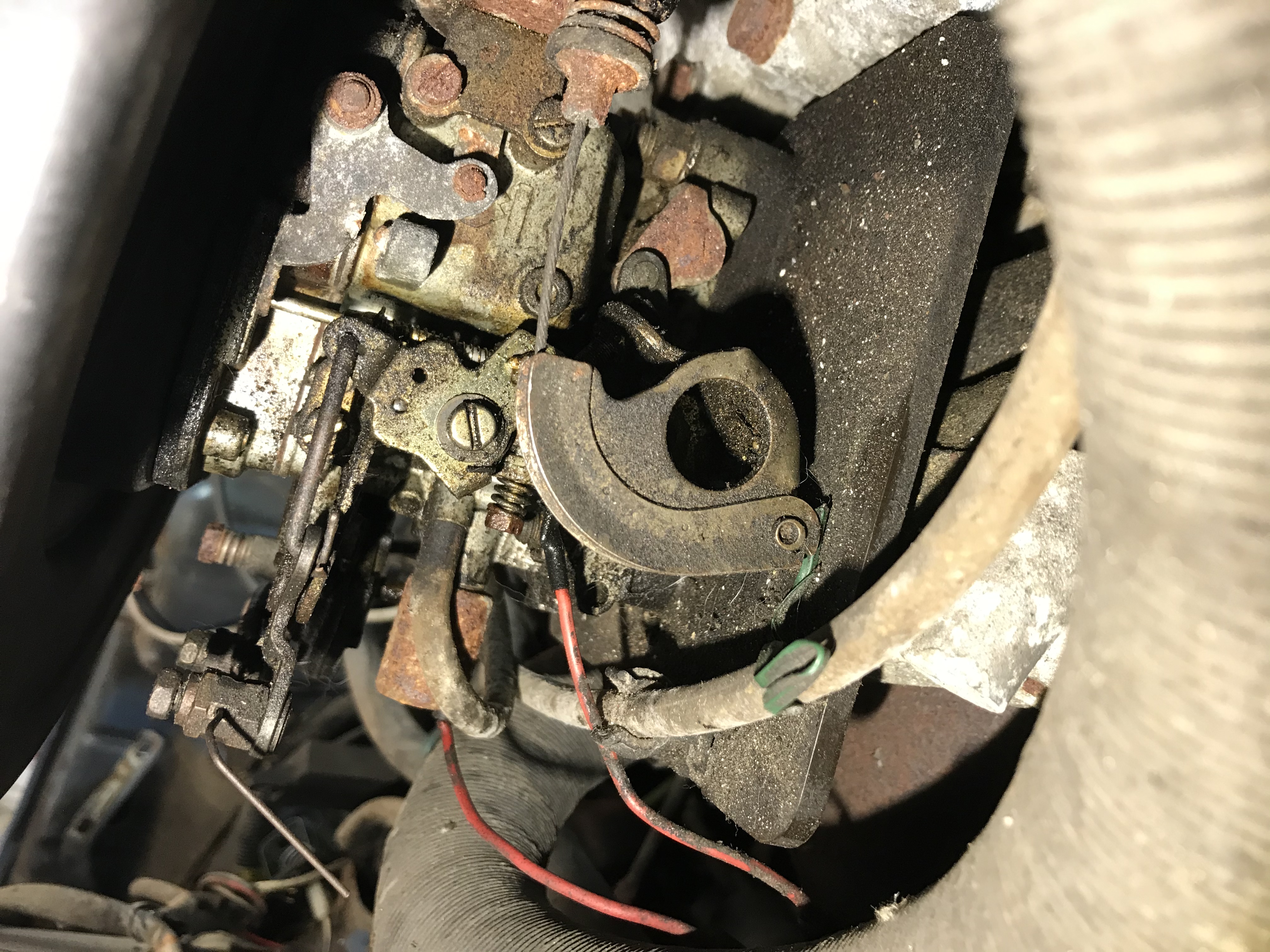

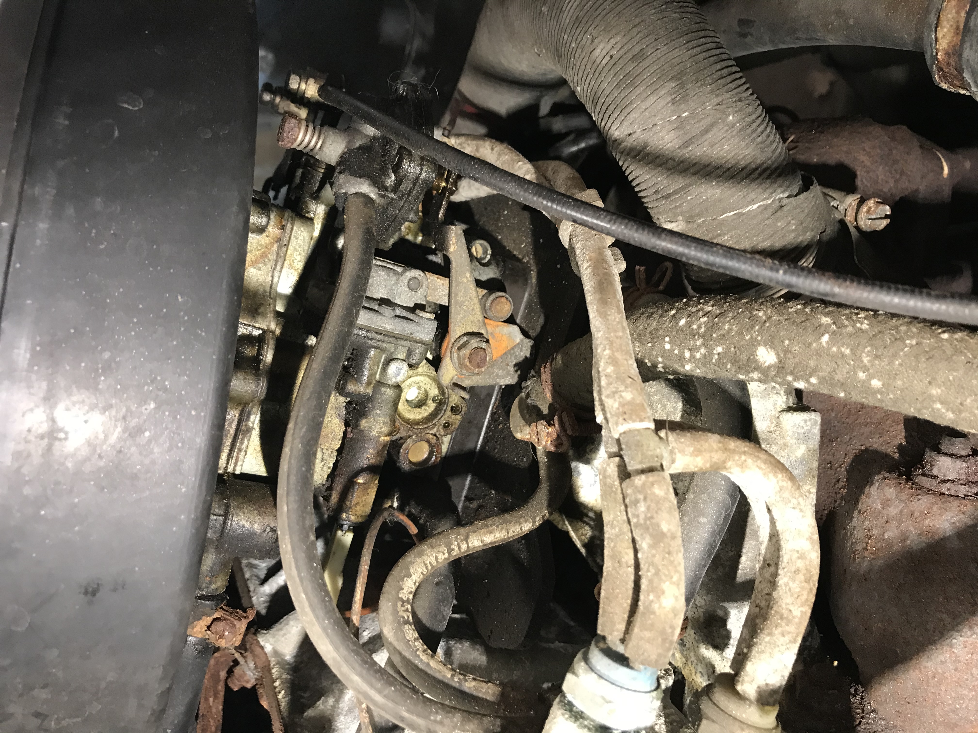

Hello, i’’m currently trying to make my fiat ritmo ready by next summer and so far i’m close to being done. But i have a few problems.
One of them is that my engine dont stay in idle, it jost goes out, i’ve got a timing light to adjust the distributor so the spark plugs sparks at the right moment. But i’ve been told i also need to adjust the idle screw on my caburettor but i don’t know where it’s placed.
I’ve uploaded 2 images of my caburettor so you can see it

There are two idle screws!
One controls the throttle plate and adjusts the RPM.
The other adjusts the Idle Mixture strength.
Both need to be correctly set.
In your first picture the throttle idle control screw is the screw with a spring around it's body just above throttle cable pulley cam.
In your second picture the idle mixture control screw is the recessed screw on the lower right of the carb body just below visible lever arm.
I also note it looks like you have an idle overrun shut-off solenoid. This is the cylindrical item with the red lead going into the back of it. This can affect idle as well.

Okay thanks i got it working now!
