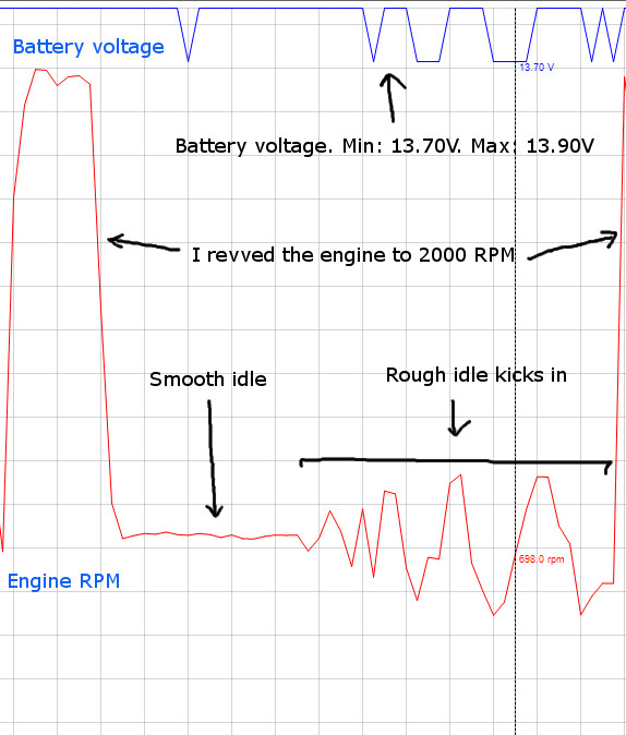

Could you monitor the battery voltage while the engine is acting up? If should be over 13V if all is good.
I would be inclined to check the voltage drop between the positive of the alternator and positive of the battery while the engine is running. Do the same for the negative. Should be a very small reading.
When the rough idle kicks in the battery fluctuates between 13.6V and 13.9V. So that looks normal when the engine slows down and speeds up by itself. I checked it with Multiecuscan.

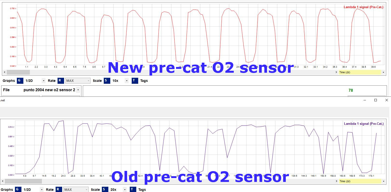

When I replaced the O2 sensor I checked the old O2 sensor with Multiecuscan and it didn`t look OK. I did a before/after check with the new 02 sensor. And the new looked it definitely better. The throttle response became also better.
I thought OK, now I got it, this is the fix for the rough idle. But unfortunately the rough idle came back a day later...
