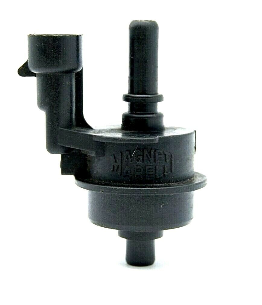

I finally found the reason for the knocking. It was the VACUUM EVAP FUEL SOLENOID. Fascinating that someone like that can behave like that? I still don't know why it knocks... This is somekind of fuel tank breathing valve. But why it start knocking only under load, never idle or gas pedal up when driving. And knocking is worst when 1500rpm (starting about 1200rpm to 3000rpm) and sound following engine rpm. And ticking only when engine is warm. It sounds like faulty injectors or valve tapping. I just can get it... If disconnecting valve wires, EML light comes on but sound is gone.
Edit: I found this kind of information "The purge solenoid is pulse modulated by the ECU. It is normal for it to click during normal operation and it should only work when the engine is under power, not at idle."
This explain a lot for me. But rattling noise is mystery. Maybe the valve itself is faulty.

Opel had an issue with their version of that valve becoming slightly noisy on several models.
