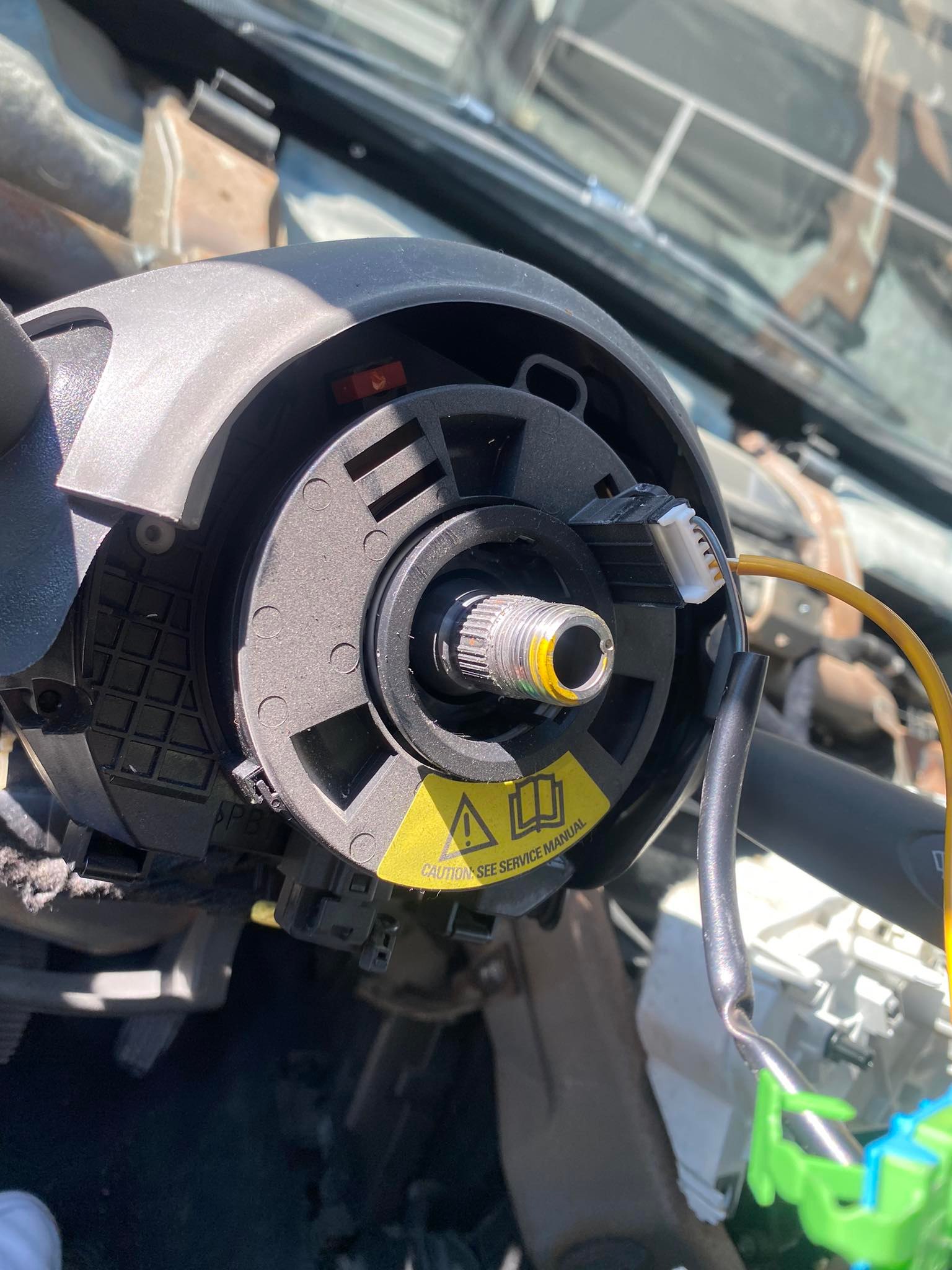

Hello . did anyone change the steering wheel from a normal steering wheel without buttons (fiat panda 2008 not 100hp) to a steering wheel with buttons volume , skip .. something like fiat panda 100hp or fiat 500 steering wheel
i have an aftermarket stereo and i want to have power steering controls ( not with bt , i already try it , and i didnt like it)

The steering wheel will physically fit the car but you will probably need the clock spring ribbon cable. However I have no idea if the wiring loom is the same on all models. I would be surprised if it is.
thank for your answer! the clock spring is the problem yea , i dont which one to pick , i dont which is the correct one
