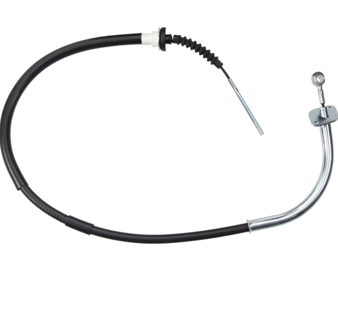

Thanks Darren. My existing cable is not reusable. The issue is the hole at the end. The models from mid 1993 have a larger hole at the end. See photo. The part codes are shown on photo and I’ve added a photo of the cable itself with the larger hole.

Guess you have it sorted by now but if not Autodoc show a couple of this part number in stock.
Oh well, as usual it is an error. The part is out of stock. This part is impossible to find new.

That's a bugger ...a few years ago I had to get one from oscaro in France they wouldn't post to UK and that was pre Brexit, have checked & they haven't any... anything RHD ...wiper drive, lights, cables can be difficult to source. There is this place which says they're available but am afraid it might be same story.
