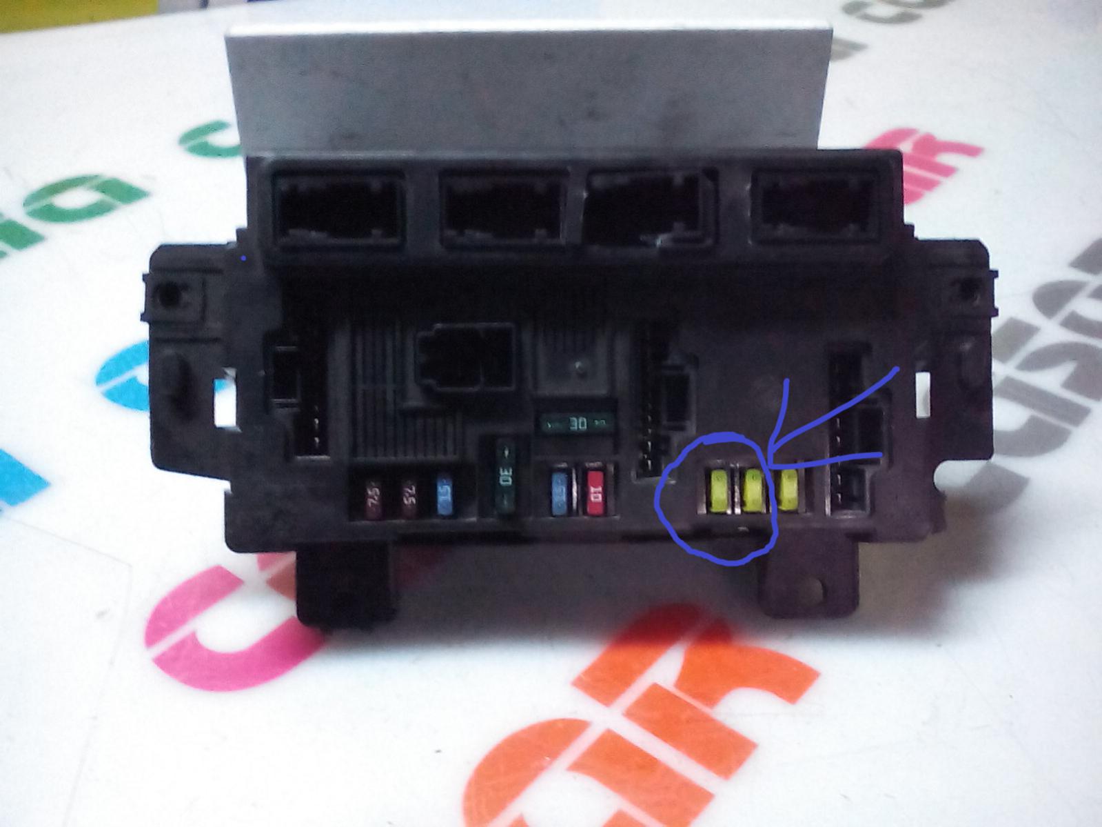

yeah I've looked at that fusebox but no fuse in there for the electric windows
my RHD is by the steering column.
left and right windows use separate fuse
if neither widow work its unlikely to be these fuse on the body computer
these are the 20A ones

Hi thanks,but I don't think it's the fuse .For some unknown reason when I pressed the swith the window went down slowly ,but when I pressed to go up ,it slowed down and stopped near top.So I'm thinking this could be the motor or needs lubricating
