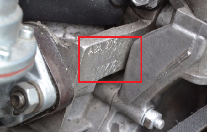

heres some of the block designations for 126 based engines.
126A5 000 - from 594cc fiat 500R's
126A 000 - from 594cc fiat 126's
126A1 000 - from 652cc fiat 126's
126A2 000 - from 698cc fiat 126 BIS engines.
The engine designation is stamped on the front case, right beside the fuel pump. If you snap a photo of it, we can then help with routes to go. This will help determine how mild or wild you can go without getting into too much machining work.
