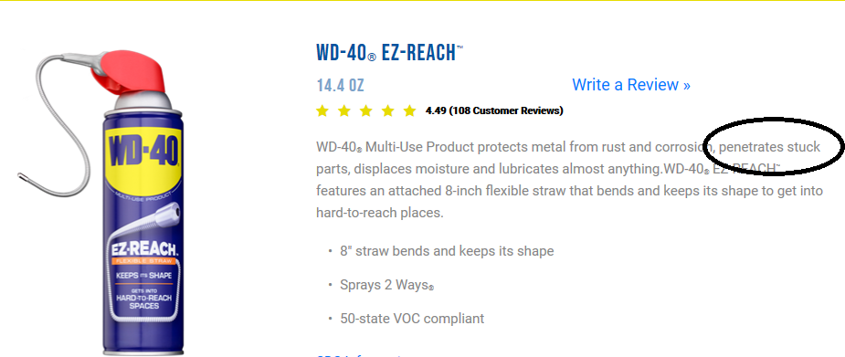

Tech tip.. GET THE ENGINE WARM WD 40 around the plugs first, leave for a few mins, undo each plug a little and spray again with WD40 so that it penetrates right down the thread

WD 40 isnt a penetrant.. ;)
Wilko sell a good aerosol penetrant for @£1
Plusgas is great..but pricey
HOT.. thats definitely the best way..
And give yourself some time..
Rushing isnt recommended :eek:
I have been using WD40 since the early 70's
And it IS a penetrating oil
LUIGI
