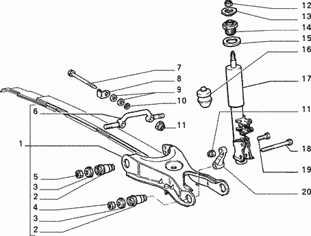

Just doing a sanity check before I go in all heavy handed. I am trying to replace the rear shocks. They are the stile withe the single spring across the center (see attached pic). I have not been able to get the bottom shock bolt out (item 18) currently letting some WD40 soak in since even though I have undone the nut (item 4) I cant get bolt (item 18) to spin or tap out.
So the question: Am I missing something or is 30 years of rust holding the bolt in place?
In which case good soak of WD40 followed by the heavy persuade (hammer) possibly bit of heat to help?

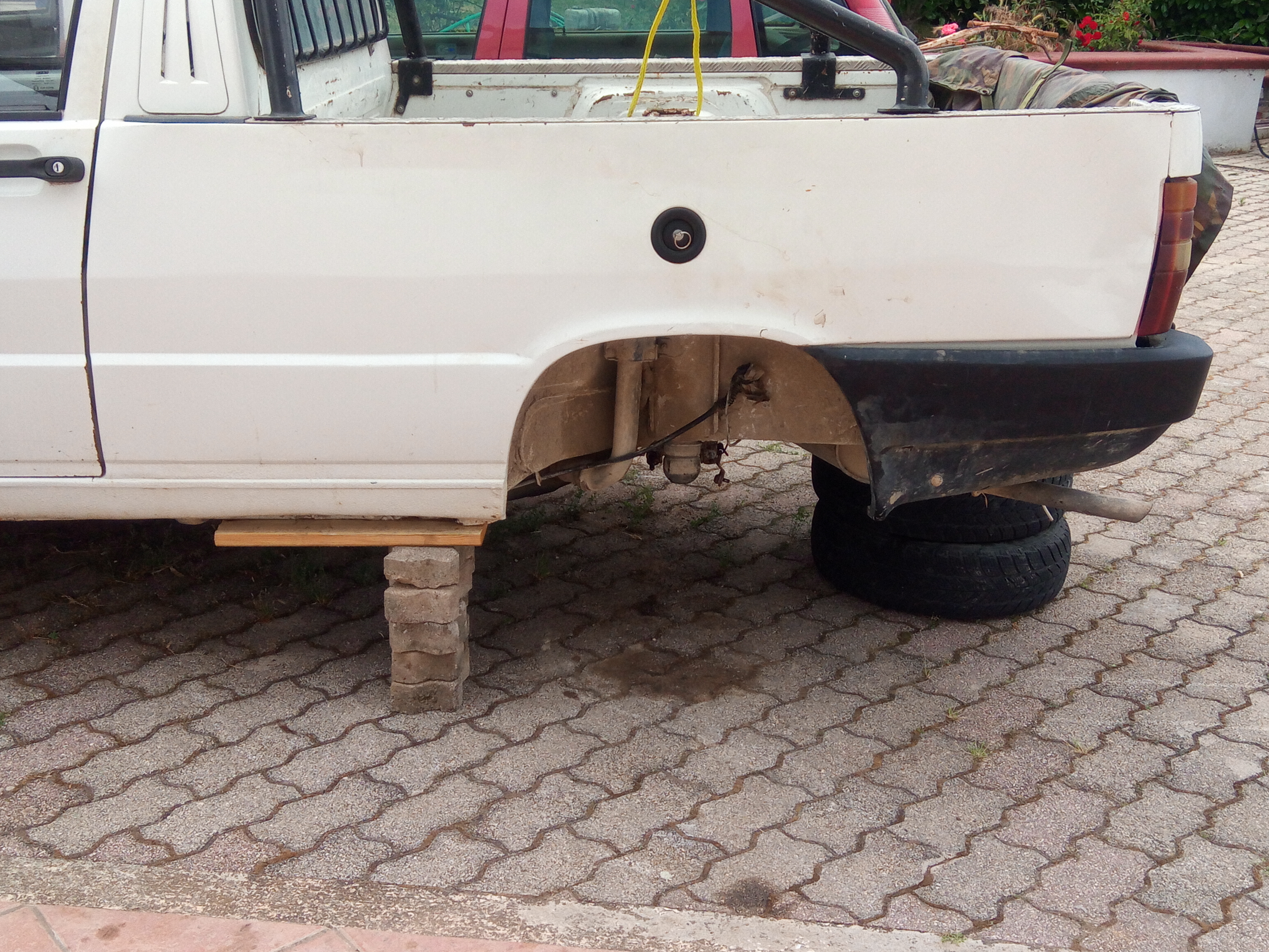

@varesecrazy thanks for the wilco tip but its a long way to go from italy:ROFLMAO: I did buy a local expensive one left for a few days then lots of heat but no joy. I guess 30 years of abuse have taken its toll. Looks like I was trying to do it right but landed up with big hammer and angle grinder to get the whole lot off so full rebuild and replacing with new parts. Hopefully will last for another 30 years (should outlast me :oops:)
By the way off topic I used to live in Varese some 20 odd years ago pickup.jpg
