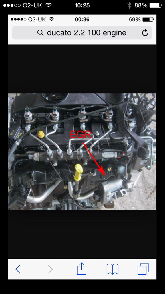

RayC /Andrew.Thanks for the video. Do you know how to get at the EGR as I have no info at all. Its an Escape 2198cc 2010. Has 3,800 on clock.
Terry
[ ImageUploadedByFIAT Forum1427279225.902168.jpgATTACH]151888[/ATTACH]

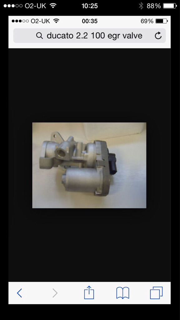

These may help if the engines correct, should be available from most motor factors like euro car parts and online parts suppliers, cost less the the unavailable genuine item
