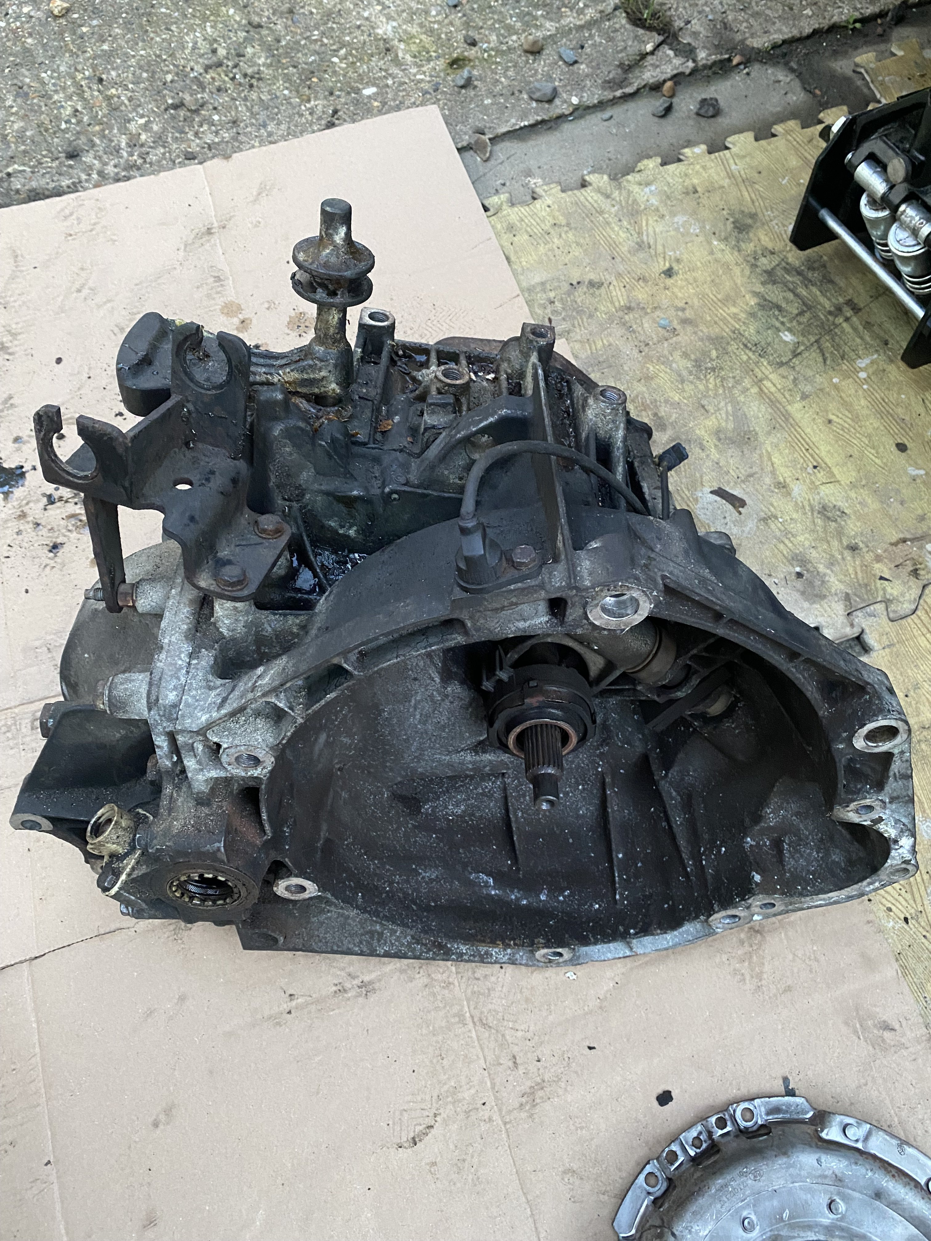

I have attached some images.
Hello , @Mrbxx , okay now this is really interesting . Yes i can confirm , that is not an MG5TU gearbox , though it is very similar . It has the same 5th gear castings , but the clutch arrangement appears to be more defined on the forward side of the box , compared to mine which is more on the top , making it totally different . I can't really fully compare it to a ME5TU , because i've never actually seen one in the flesh , so to speak . But the best i can say is the clutch lever is more in line with the MG , despite being a different shape , it's roughly in the same place as the MG . It also appears to have a dip stick , on the forward side of the box .
Now before i go any further , can i just ask you to confirm the Vehicle make , engine size , weight , and vehicle configuration , ie pop up , a class , c class or though unlikely at this age , b class . Vehicle make is important , Fiat , Peugeot , or Citroen , and perhaps more importantly , you call the gearbox ML5 , there should be at least one more letter after that , maybe 2 , do you have them ?
I was told that my box is a ML5T due to the differential unbolting.
Sorry i missed that , but that was the information i was trying to gain ,

See this looks very similar to mine however the clutch folk does not come come in from the top of the box on mine. Apparently I have the rarest box known to man, all being said now that I have it apart the intervals don't look to bad in my unprofessional opinion. I was expecting to find 1st and 3rd gears completely shot but turns out 5th looks in worse condition than any others. And I am having no issues with 5th!

Hmmm , now that's most intriguing , because this is the gearbox , you're been told you have .
Okay , so i'm guessing you have the gearbox at home . It will have some markings on it , BUT , they will be stamped on the outside , though it is possible there could be a plate . Either way , it's likely covered in muck , but to be brutally honest the rub is , it could quite literally be anywhere . In the case of the MG , and ME 5's , it's on the upper casing between the bell housing , and differential . More or less beside the forward most cable trap for the gearbox cables , not the clutch .
I would suggest looking there first .
The chances are , you will need to clean the casing first , and for that i would suggest hot water . And by that , i mean as hot as you can stand , mixed with some fairey liquid . The misses might object somewhat , but as an engine degreaser , it's a very acceptable alternative . I've had varying success with other brands , but i've probably got the lead on you , as i'm not married .You're also need a stiff brush , stiffest you can find , i'm afraid a paint brush won't fly , and possible a wire brush . Personally i would use an electric drill (but not with water for obvious reasons , huh) , and scrub the bugger . Do make sure any access to the internal components are blocked , you don't want any water , or dust to get inside .
Now the markings your looking for , should have all the important information , regarding the gearbox , including the type and serial number . It's possible i've located an early ML5 , and yours is a later version , however it's very rare for something like this to be changed in this manner using the same part number . It's far more likely a superseded number , and this maybe shown in your part number , or gearbox type . For example another number or letter after the last T , ie ML5T?
Now i'm gonna push this one forward . It does appear to be slightly different , however though it came up during a ML5T search , it does appear to have a different part number . It's also pretty much on target , both for make , year , and cubic capacity , plus the fork pivot is forward at the top by roughly 45 degrees . Just take a look
