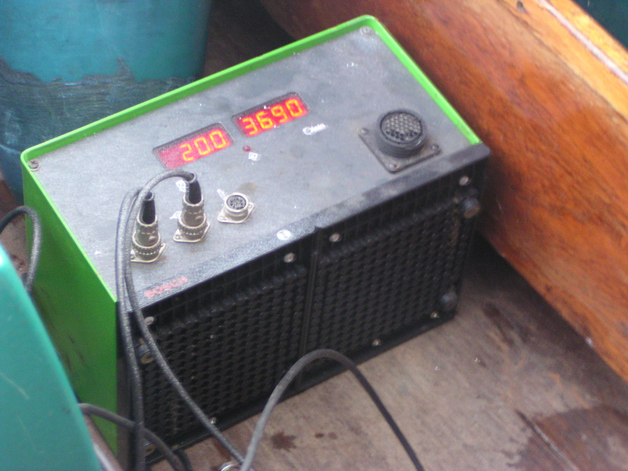

It may take a search but on the last couple of months I contributed to a post giving timing belt details, but also injector pump timing specs and how to do it with a dial gauge in the hole at back of pump where pipes come out.
If you have clear timing marks accessible at crank pulley that are accurate , then it is possible to check using a timing light and sensor from Number 1 injector.
No good to you but I have a Bosch Timing light/sensor and rev counter unit.:)
Pic below shows 20 degrees of advance @3690 Rpm on Sofim 2.8 in my boat on my Bosch kit around 26 knots.:)

Whilst a proper working wax stat advance set up is best for smoother cold start running etc. If you look on my middle photo above you may see that nether the flame device or the wax stat are connected, the only connection id the solenoid on off wire and I used that boat all year around for over four years with no issues re starting or smoke even when ice on boat.:)
