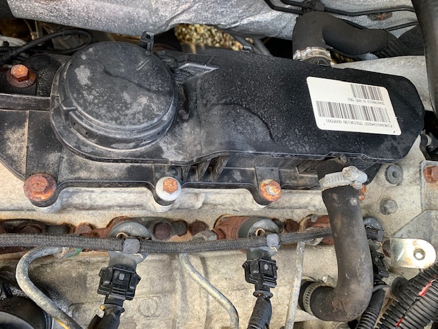

The 2 photos show the offending valve/sensor ( disconnected) in the black vertical hose going up to the top of the engine and the black (breather?) box on top of the engine.

Thanks for your views on this and yes I can confirm engine is 2.3. I’d never heard of a blow by heater before certainly looks like the component Well done all and thanks for your research and links to other threads and forums.

Good morning, Ive just checked the disconnected plug and there is a constant 12V on it therefore not temperature switched by a relay or perhaps the thermistor for switching is in the device itself? Perhaps its just a "hot wire"??For now Im leaving it disconnected as it is definitely faulty.
