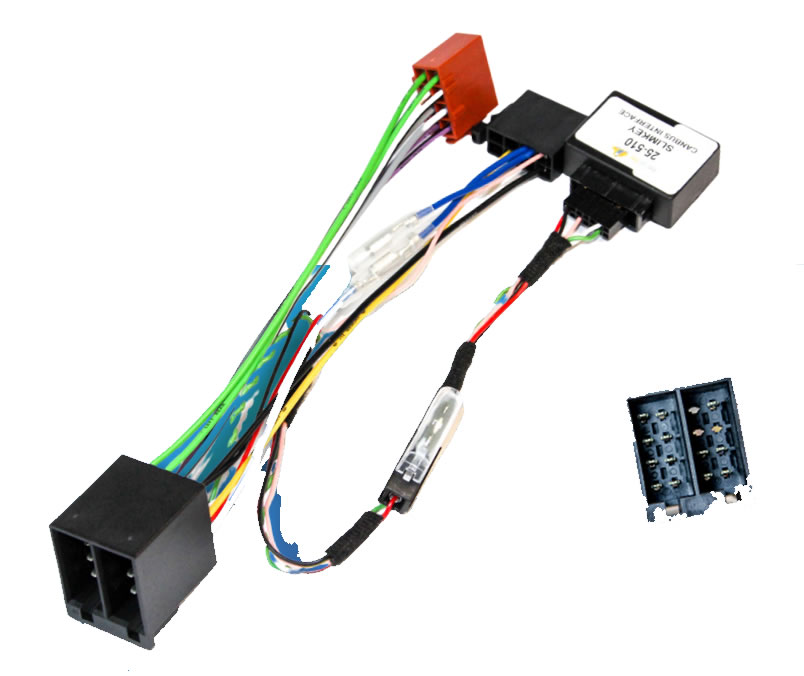

I'm now discovering "Canbus adapter" harnesses, for specific makes and models, that link aftermarket radios into the Doblo's wiring, including connections to the Canbus. The cheapest so far is around £40, so I'm trying to find out what the actual connections are and if there are any intermediate electronics within them.

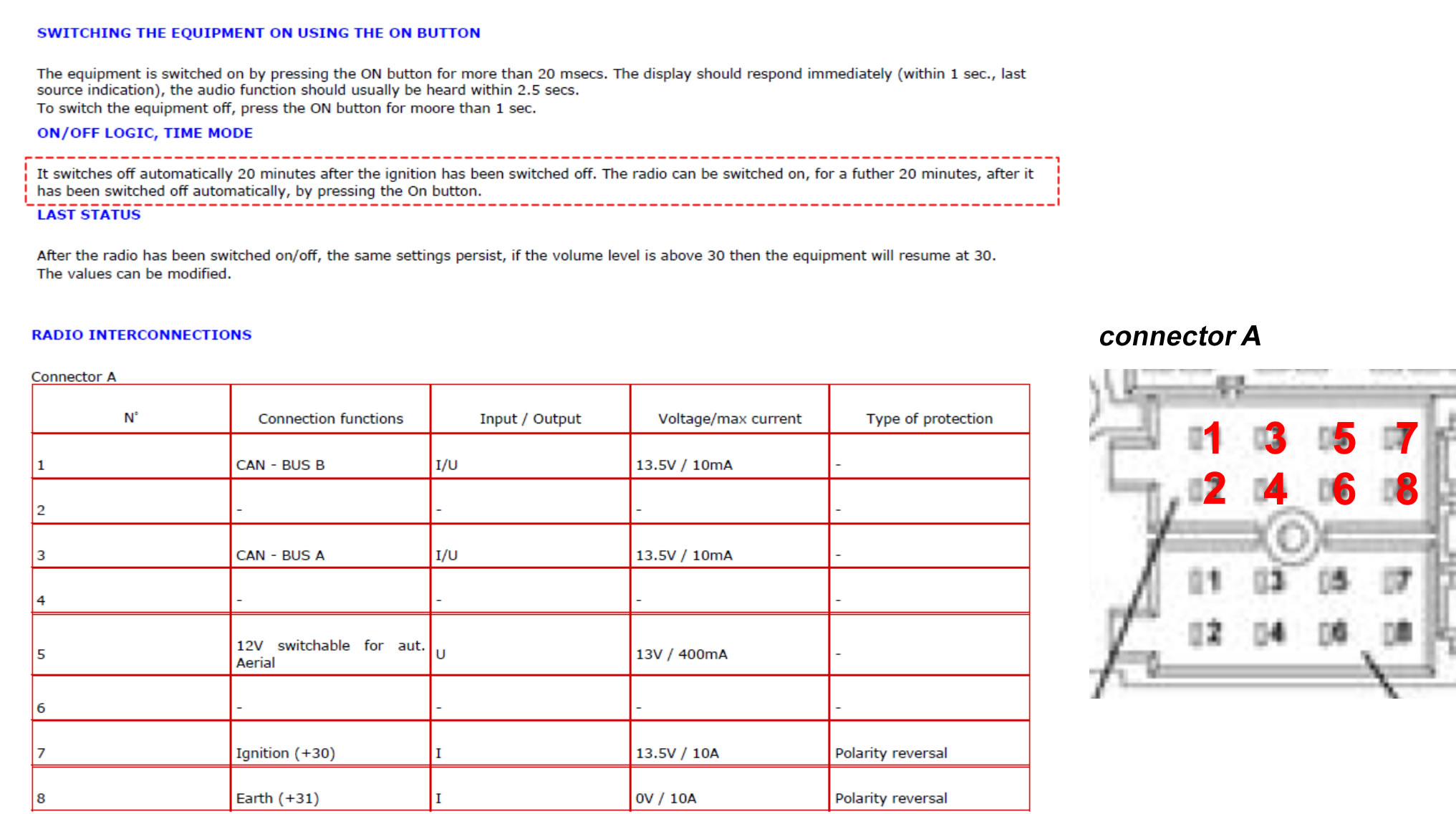

The (excellent) Doblo workshop manual downloadable from this forum throws more light on the subject. (I should have searched it first).
The pages about the factory fitted radios explains that it somehow links into the car's canbus to be able to auto switch off when the key is withdrawn, and also allows off-engine usage in 20 minute intervals. The accompanying wiring diagrams show connections to the car's canbus "A" and "B" wires within the radio's standard DIN connector. So presumably the special Doblo canbus adapter somehow connects this to aftermarket radios via some unknown componentry.

So I had two main options to get the Android head unit working, either pay about £40 for a Canbus "interface" to daisy-chain in the radio's DIN loom, or connect the head unit's "accessory" switched positive lead to its constant positive lead. I decided on the latter option, not only because it was cheaper, but it would give me full use of the head unit whether the engine was running or not.

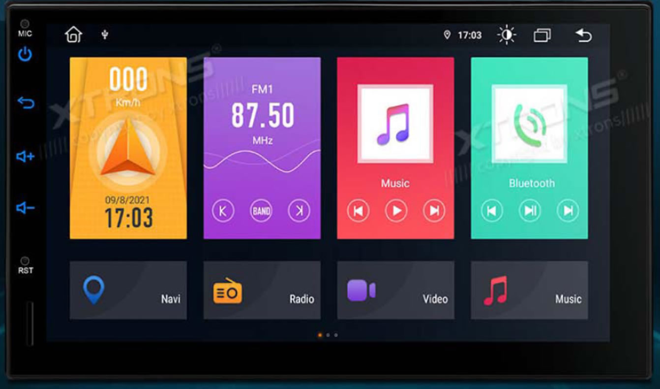

The downside was that by default, when you turn an Android head unit off, it goes into standby mode instead of switching right off, so it would drain even a 60ah battery within a few days. Further research into that problem revealed that most of these units have a well hidden factory setting to toggle the off switch to "instant off", which would cut the standby battery consumption to a fraction of milliamps. As Sod's law would have though, I can't find that setting on my (xTrons) head unit.
So my solution was to fit an SPDT (single pole double throw) on/off/on toggle switch unobtrusivly in the side of the radio binnacle housing.
This connects the radio's "accessory" power wire to either the radio's constant power wire (for occasional use with the engine off), or to a power wire that is live when the engine is running, so that it comes on when the engine is started, and goes off (completely), when the engine is stopped.
I must say, I'm impressed with the functionality of this relatively affordable head unit. It gives me my first automatic reversing camera, great audio from the full function RDS tuner, my entire music collection from a micro-sd card, and even OBD2 diagnostics from a cheapo blutooth ODB dongle. The double-din replacement dashboard binnacle housing was only obtainable from China, but it came within two weeks via Amazon, for £32.
