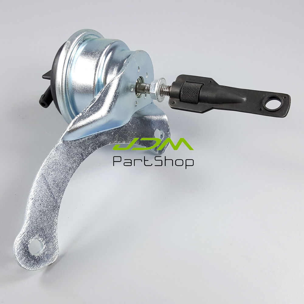

I was having same issue with my mulltijet diesel Fiorino and it was a seized turbo waste gate common on these engines and would only as you say get to 3000 revs.
I have sorted mine myself with a long flat blade screwdriver and WD40
There are videos on YouTube showing how to do this

.... But the common fault with the 1.3 multijet Diesel is the Turbo Wastgate getting stuck.... Check this first as it costs nothing apart from WD40

If you need a new waste gate £30 gets you a new one!
