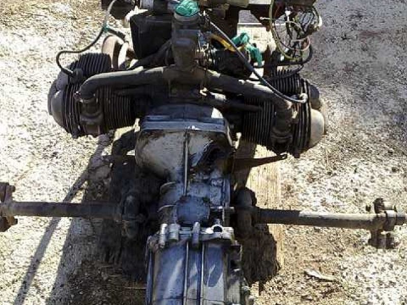

This is the drivetrain from the bmw, it’s also mounted behind the rear wheel
I see there is no cooling fan and cowlings so surely overheating when inside rear engine compartment?
I am not trying to pour cold water on it as I think it is an interesting project and over the years I have put many different engines in cars and boats, although mainly diesels for economy reasons.:)
I just try and check the practical issues that may come along.
Thanks for the insights, and I look for advice/opinions, so this is great input. From what I´ve seen, the fan is mounted on the shaft of the engine, similar to VW type3 & Type 4 engines. Perhaps with increased volume and power I would need to add more cooling to it.
