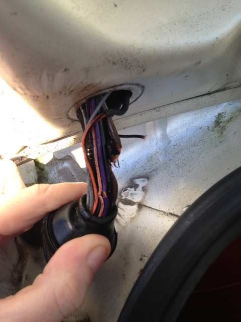

You might find that inside the rubber boot looks like this!!!
