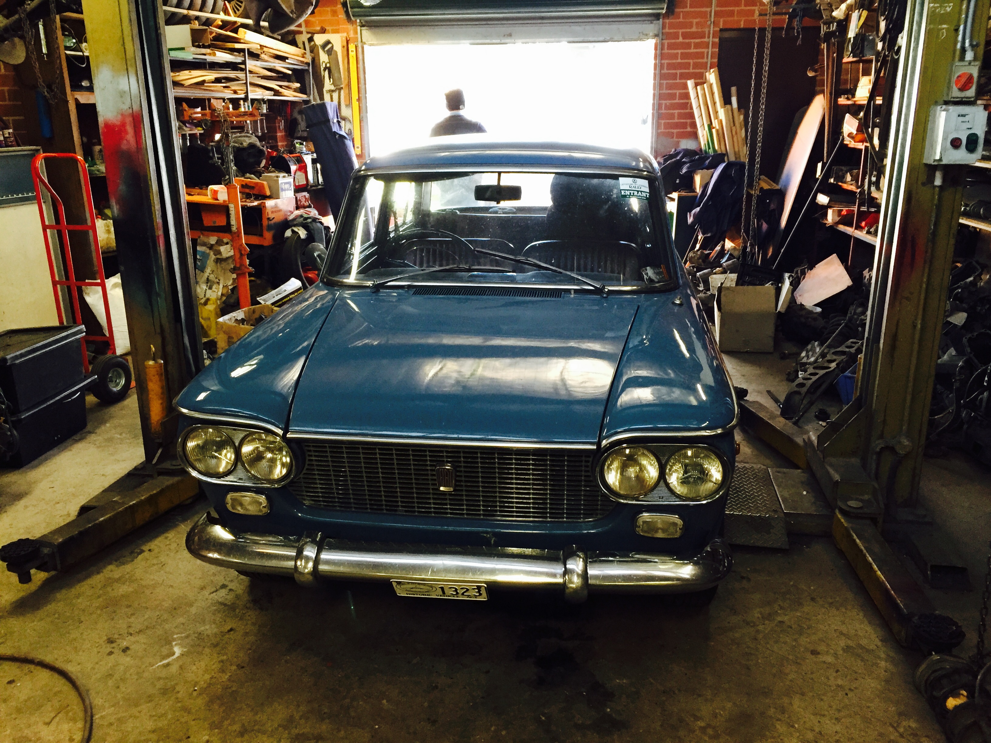

Here's what's under the hood. Fiat 125 1600 twin cam with Fiat. 124BC carbies and attached to the 125 five speed gearbox. Cruises nicely and sounds good too.

Hi,
Being a car that is over 50 years old, various things need replacing at times. There is no particular weak point that I can think of apart from age.
For twincam and 5 speed gearbox conversion
125 cross member
Experimented with engine mount brackets to get best offset. ( there are different types)
Converted accelerator pedal to cable using shortened pedal from 124 sport - needed to weld brackets for pedal inside and cable mount in engine bay
Cable clutch conversion - used 125 clutch pedal mounted on 1500 pedal box. To get pedal box out need to remove front suspension and steering column.
Made cable mount that had strengthening on both sides of firewall Cut hole in tunnel for gearbox and made a new cover.
Replaced 124/125 donut on end of gearbox with 1500 version to match up with driveshaft There were two types of speedo drive, one went the wrong way
Used original radiator with electric fan which had just enough clearance to engine
Other mod was 125 rear disc brakes. Used 125 axles etc all bolted in to 1500 diff housing
