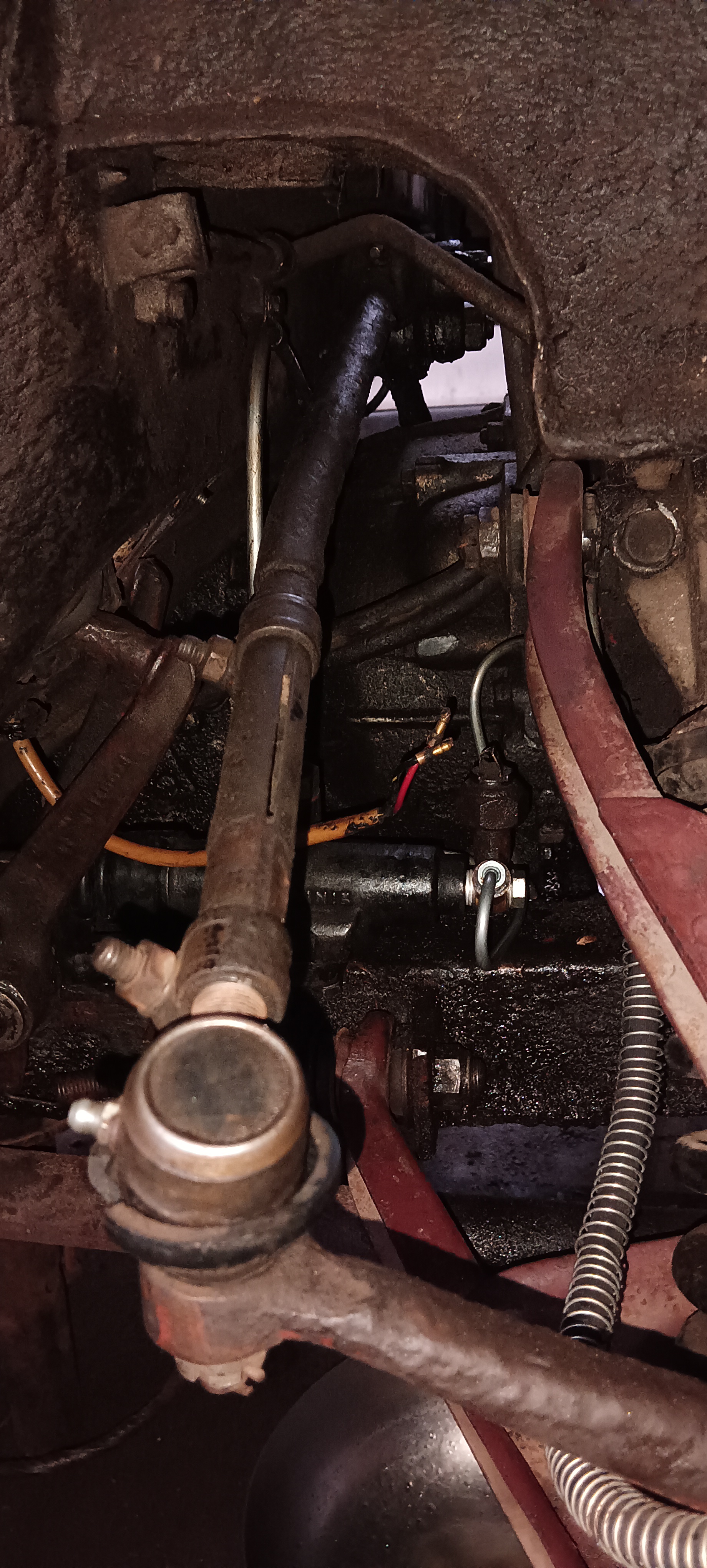

Yes I did manage to remove and fix the master cylinder. Here in India, there was a company named TVS Girling (also called "Brakes India") which used to make these. Unfortunately, even these are very hard to procure so I bought a local repro. The repro worked for 3 days before I noticed drips from the dust cover. All this was done by my mechanic but he was too busy to fix the new leaking MC so I had to do it myself (reason why I posted here).

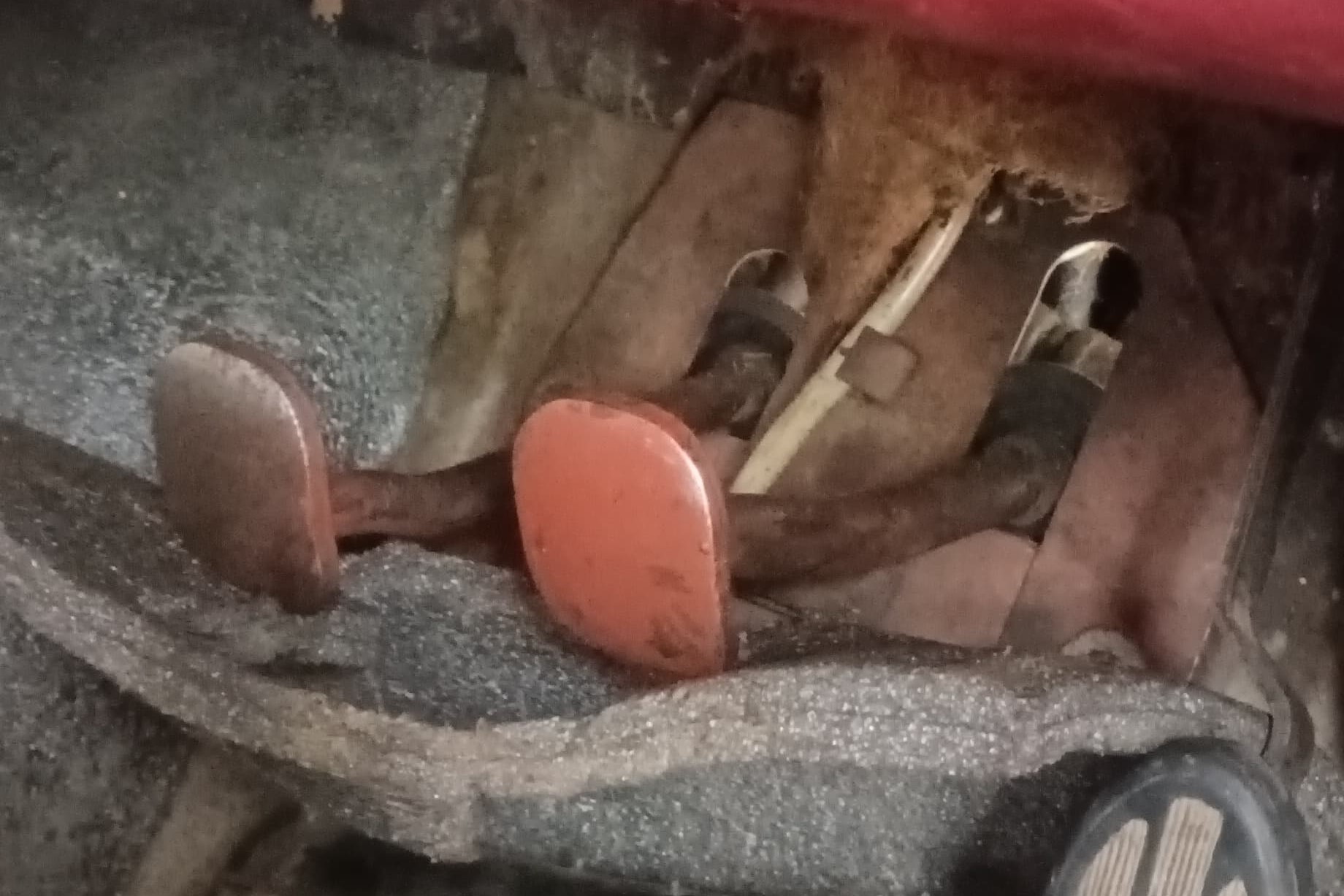

Finally, after a lot of research and asking around, I was told I could use the repro but with a TVS Girling major kit inside (they still make these mercifully). The kit includes the seals and a new piston. I removed the master cylinder (was a bit tricky as you mentioned). The biggest issue was I couldn't get the pedal set out in one piece. I had to remove the clutch pedal and move it around to make room and get the platform that houses the MC off the subframe. I also inspected the bore myself and it was in perfect shape. The rest of it was a breeze including bleeding. Adjusting the brakes unfortunately hasn't been that easy. It's been 3 months since I did this and I am glad to report the system is working perfectly. No drop in fluid levels at all.
Attaching a few pics of the master cylinder overhaul (in no particular order below)
