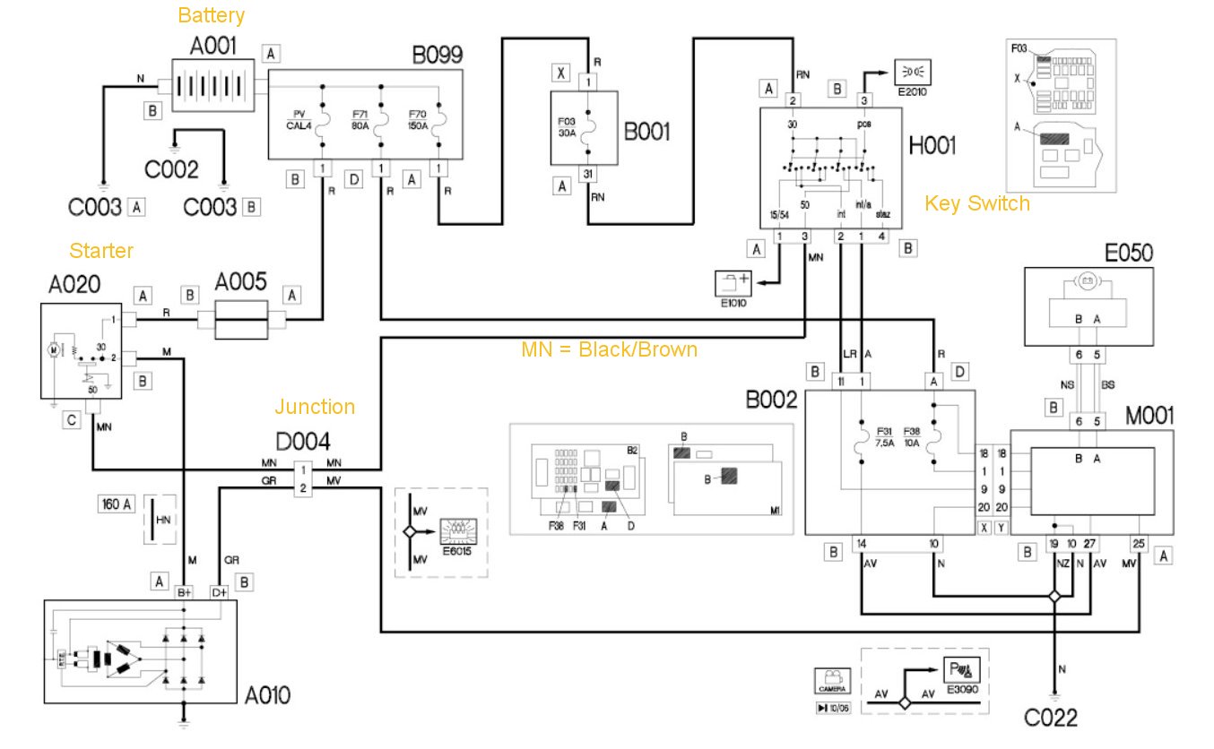

Hi magicmax
If your starter and battery are in good shape, the only other thing that could slow down cranking is the total resistance of the cables (including the earth return) and their various junctions. I don't know how you tested the earth strap, but these are known to suffer from corrosion within the crimped lugs which cannot be seen by visual inspection. This increases the resistance from an ideal 1 milliohm to something higher, but still very low by normal standards. Starter current probably peaks at 1000 Amps and then drops to 600 Amps when cranking, so ultra low resistance is crucial. I suggest you replace the strap anyway, probably cheaper to get one made up than pay Fiat prices, but check first. If you prefer, you could use a test voltmeter with extended probe wires to measure the voltage drop between the engine block and the battery negative terminal whilst the engine is cranking. I'd expect to see no more than 0.5 volts. The other component worth checking is the junction A005 which incorporates the "Jump Start" point (under a plastic shroud near the under bonnet fuse box). It's possible the bolted connections have corroded.

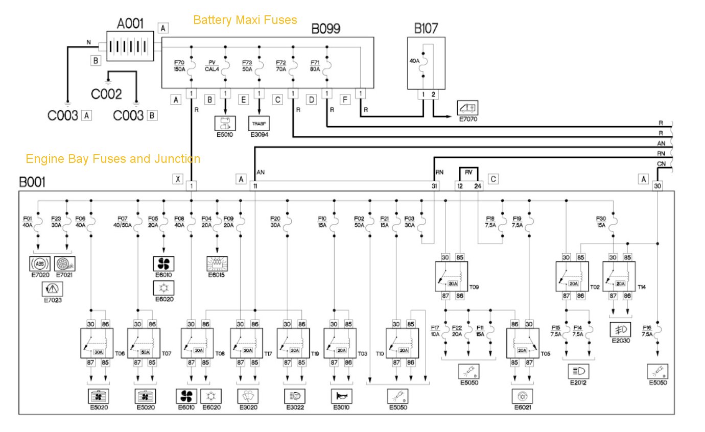

Next to the battery is a "Maxi Fuse" fusebox, which is the first stage of fusing. There are 5 fuses as standard:
A special Cal4 Fuse for the starter motor
F70 (150 Amp) which supplies the B001 Fuse box/junction unit in the Engine Compartment
F71 (80 Amp) which supplies the main part of the B002 Fuse box/junction unit under the Dashboard
F72 (70 Amp) which supplies the secondary part of the B002 Fuse box/junction unit under the Dashboard
F73 (50 Amp) which supplies the motorhome converter's socket
Be aware that Fiat changed things over the years, and the motorhome converter may have added their own wiring/fuses. Don't worry about the paired "overkill" cables, they are presumably to carry the high charging current from alternator to leisure batteries with minimal voltage drop.
The "leakage" current of 1.5 Amps is quite high. To track down where it's going, the only thing I can suggest is to be methodical and follow a programme of removing fuses one at a time (including the ones at the next stage after the maxi fuses) unit the current ceases. I assume you have eliminated the interior light ? Faulty alternator diodes can also give this effect, but I think you have discounted that.
