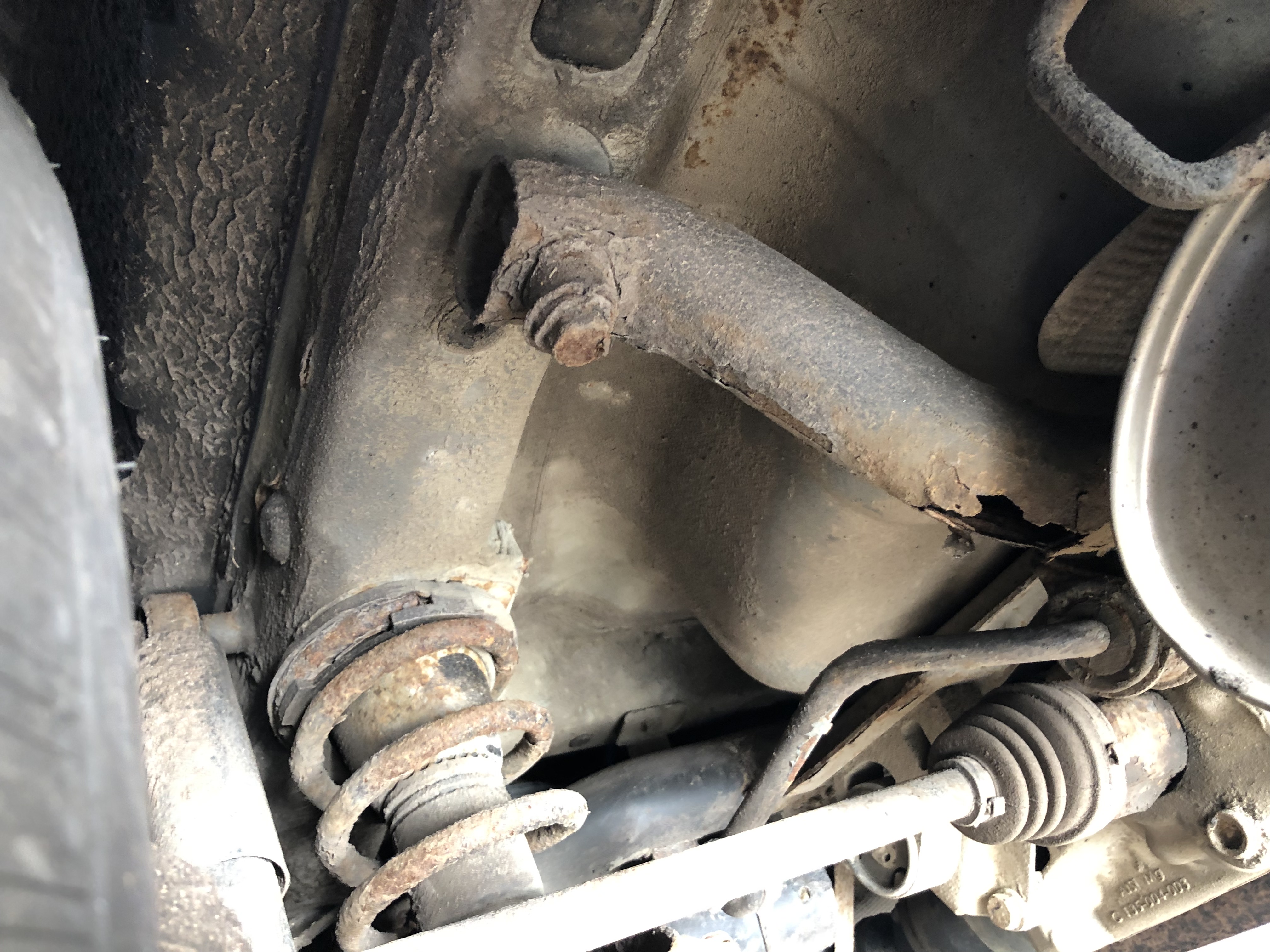

Rot in the rear subframe will scrap the car
It’s happened on here at least 2x
I would but some rust prevention inside. The subframe seems to rot from the inside due to water entering the open ends
Not my photo. L
Mine does look ok (touch wood) and a former keeper did have a professional waxoyl done. Having said that it won’t hurt that when i do the rear shocks in a few weeks, that I do a bit of a clean up and refresh 👍🏻
Blimey that tubular brace bar or what ever it is looks a bit sad.
Yep rear subframe
Looks like water enters and sits there. First you see is a hole as it rots from the inside

This has been discussed at least once before. IIRC the conclusion was that, unless someone starts producing pattern replacements for the 4WD subframes, either repairing a well rusted one or fabricating from scratch is not trivial and will likely cost multiple thousands. OEM parts are seemingly no longer available in the UK, and when they last were, cost over £2000 and that's before fitting. Even tatty secondhand examples seem to fetch north of a grand, so I'd echo those saying this is one part well worth protecting if you're planning on keeping the car for awhile.
Thankfully for 2WD owners there are now reasonably priced new aftermarket axles available; this (particularly with the current prices being asked for small £30RFL cars) is going to save a lot of vehicles that otherwise would have been scrapped. Unfortunately the 4WD subframe design is completely different.

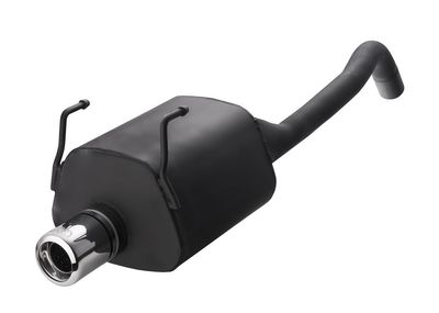

The diesel has a large bore back box. A 100HP spec silencer would probably work -
Or this for the diesel (AFAIK, 169 never had a DPF filter)
