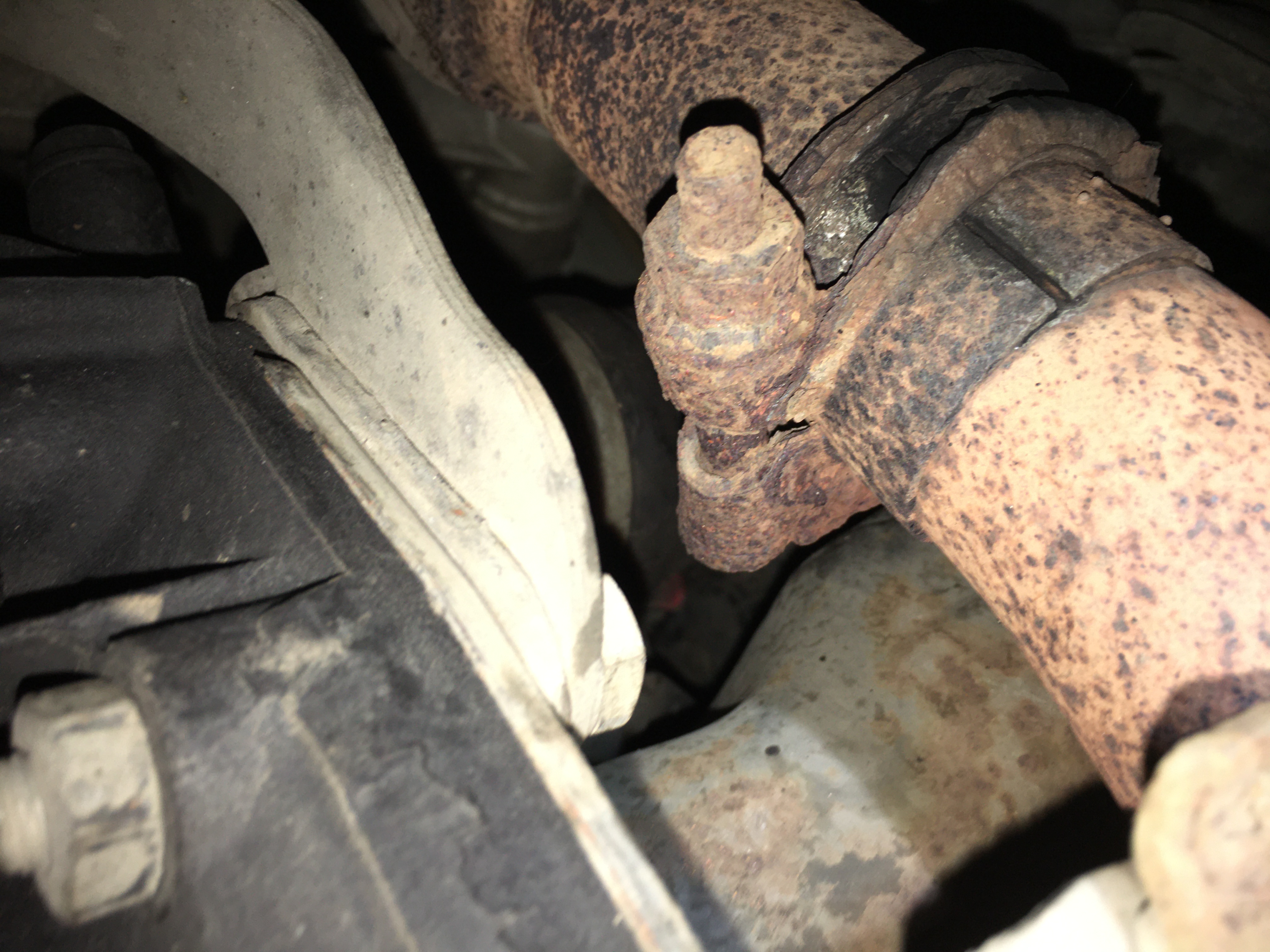

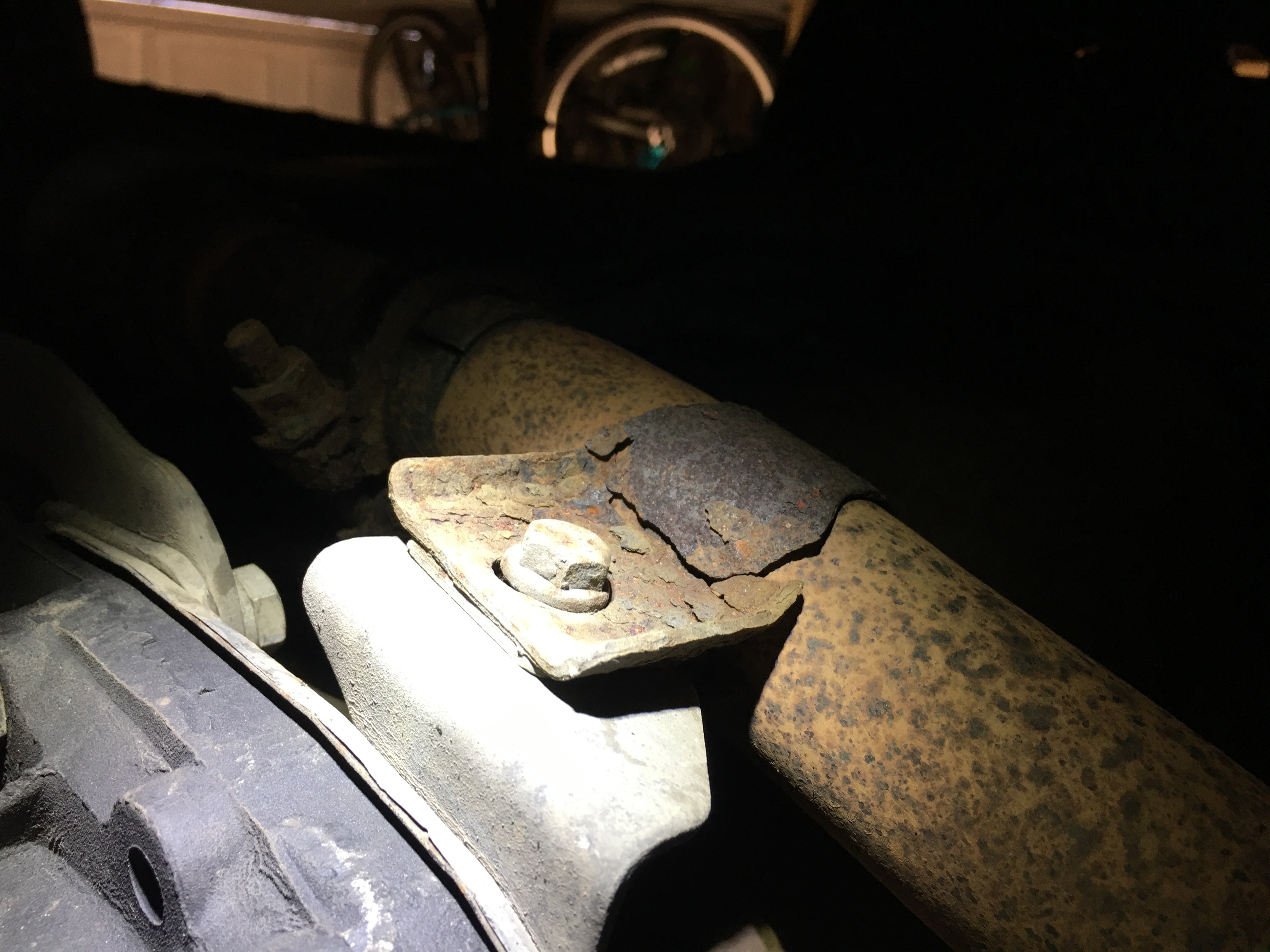

So Picture of the front clamp...think that's a bit passed its best.
The second one appears to be a bolted (in effect jubilee clip)clamp that holds the centre section to the front section?

What sort of paste?
Looks like there is a small piece of metal between the plate anyway (i think) on the existing bracket.....or were you talking between the bracket and gear box?

So the old clamp just fell to bits…my question now….have I got to separate the exhaust sections to replace or manually open the jaws and stress the metal before squeezing shut onto the original clamp lock bolt point. Can’t find any video that shows this for a 500, they only seem to show back boxes etc
