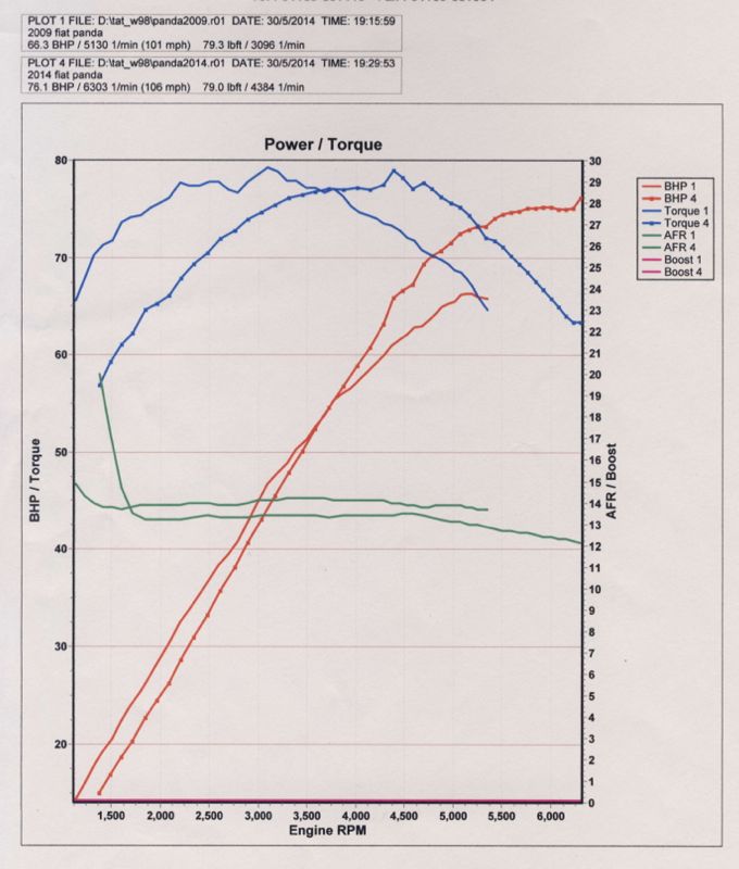

What might be helpful is the post with rolling road torque figures from the Euro5 and Euro6 engines showing a drop in torque on the latest version*. This might be proof to Fiat there IS something wrong and not us being inept at driving the bloody thing properly!
(*i apologize, i looked for the post, could not find it but it was related to the same engine in the panda)

The rolling road test results compared my new Panda to my 09 Panda (now my daughter's car). I have attached a copy here. I have been putting posts on the 500 pages as the problems are the same.
Thanks for posting that up David (y)

Actually David Bliss's post compares the latest Euro 6 1.2 with the 2009 60HP Euro 4 engine. The Euro 4 engine was never avalable in the 500.
David's graphs are still useful, but unfortunately they don't provide a comparison of the performance of the 1.2 in the 500, pre and post update.
