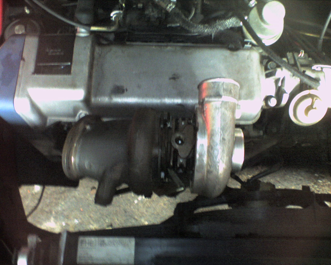

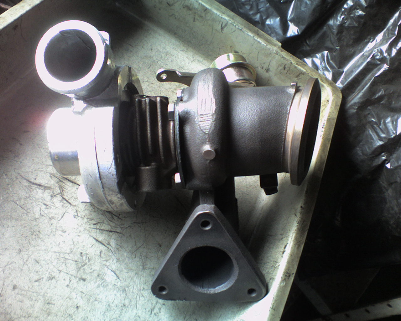

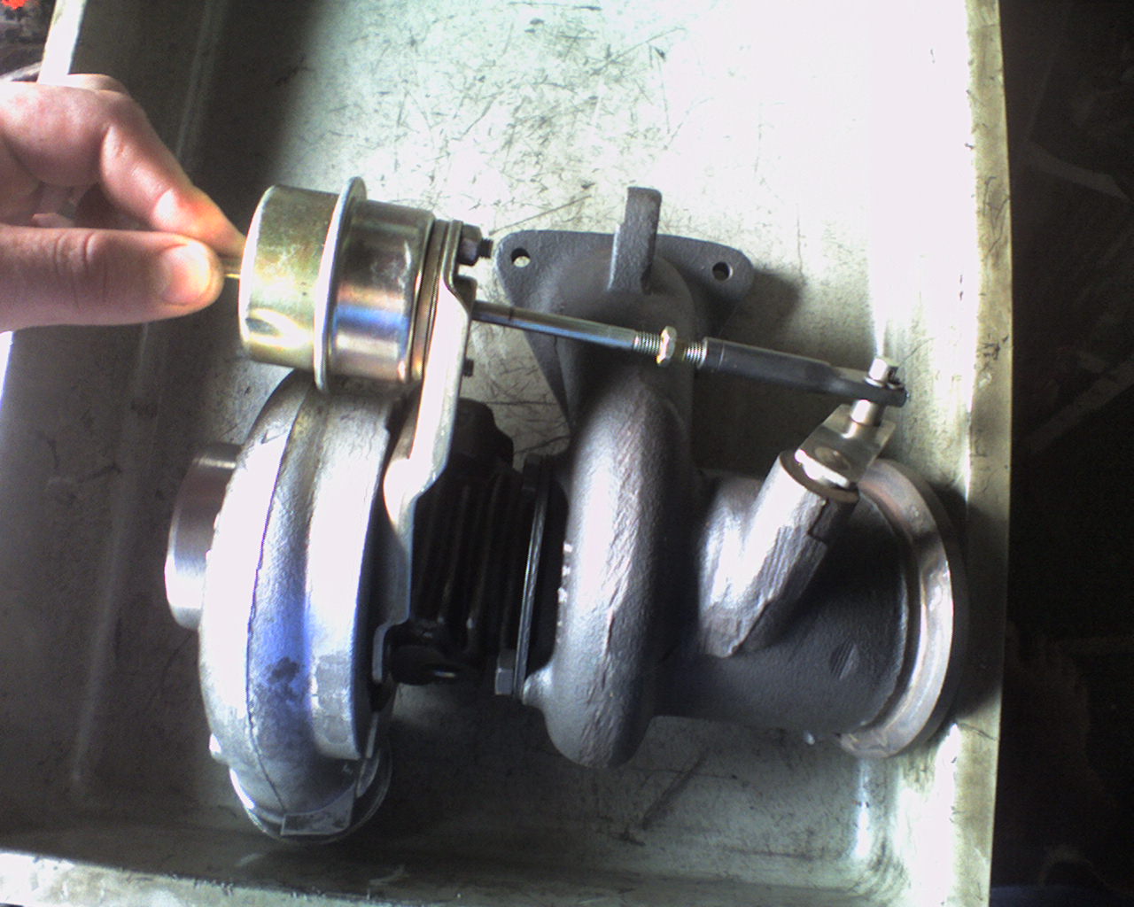

I started with my conversion, turbo branch is finished and turbo mounted, just need to modify my sump for return and do all my intake and exhaust piping. going to run low boost at first say 0.4 bar till I got my new engine sorted.

odd place to mount the turbo :confused:
surely it's going to melt the bonnet there.. how are you running the exhaust downpipe - looks like a sevre bend!

when i'm finished with my oil piping and intake piping, i'm gonna get the downpipe fitted with the rest of the freeflow system.the whole system inc my manifold is stainless steel, as i find that on turbo conversions the manifold tends to crack too easy,gonna put a heatshield over the turbo & exhaust wrap around the exhaust piping.teh turbo is also more than 5cm away from the bonnet, as for the bent, it's going to run from the turbo past the oil filter, then underneath the sump.planned all of this carefully with my exhaust installer before begining
