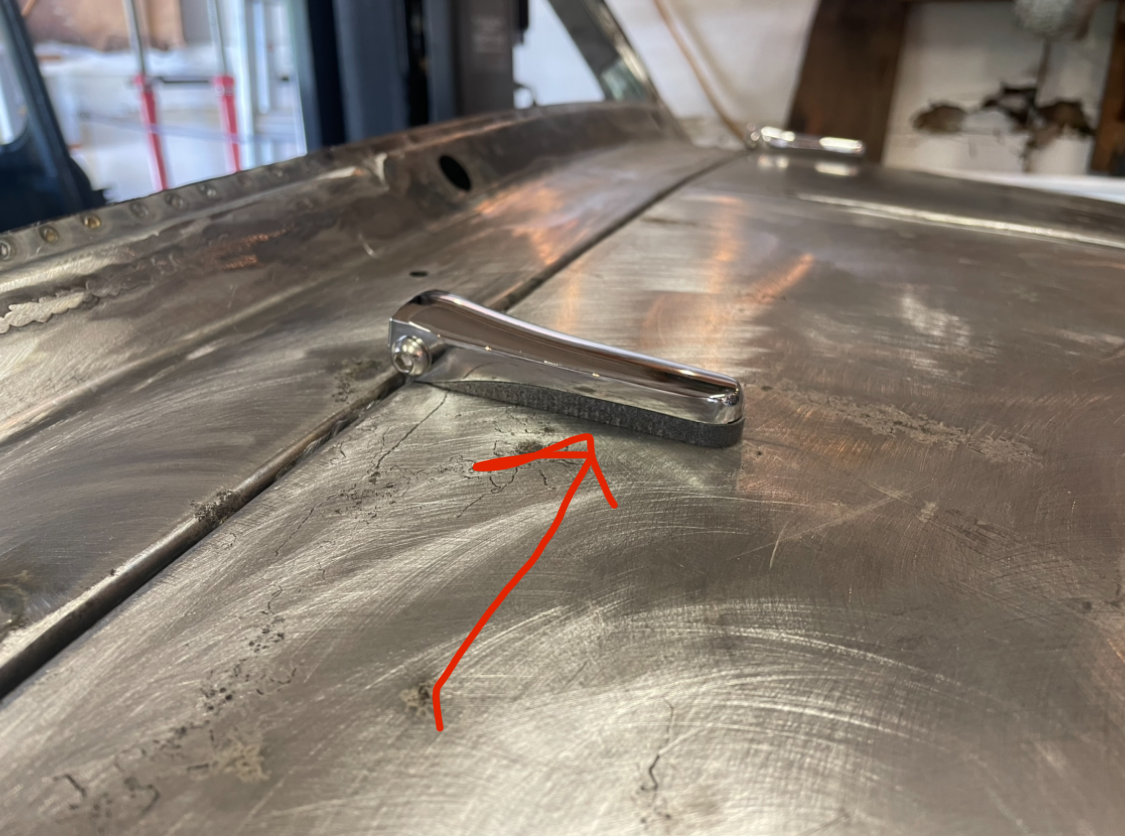

Hey @FR85 did you get to the bottom of your hinge hunt?
I used these hinges on my bonnet…
https://mrfiat.com/products/fiat-500-engine-hood-hinge-set
… And I imagine they could be used for the boot lid as well. The issue I had with them is they are contoured to fit the 500 panel. So, I had to 3D print some spacers for the 600 hood (crappy red arrow below). I would be happy to share the cad file for the spacer if you decide to go this route.
